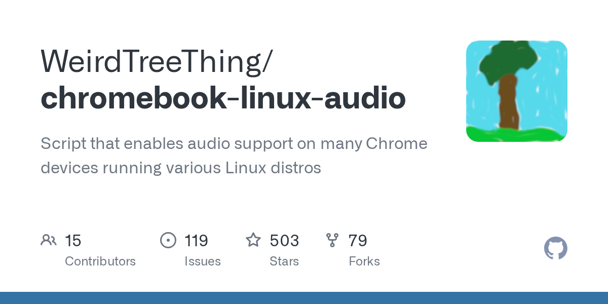

Chromebook users have used this to fix audio

You got a Voxel :wink: The link above should solve the problem. Preferably use pulseaudio and not pipewire.

MrChromebox has good support for Linux on chromebook systems, but the audio devices need driver patches, firmware and topology files from WeirdTreeThing.
Patches and additional firmware might be incorporated into ALSA and related packages in the future, so audio works “out-of-the-box”, but the chrultrabook community is the best place for chromebook support at the moment
