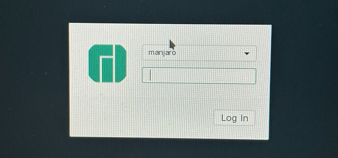

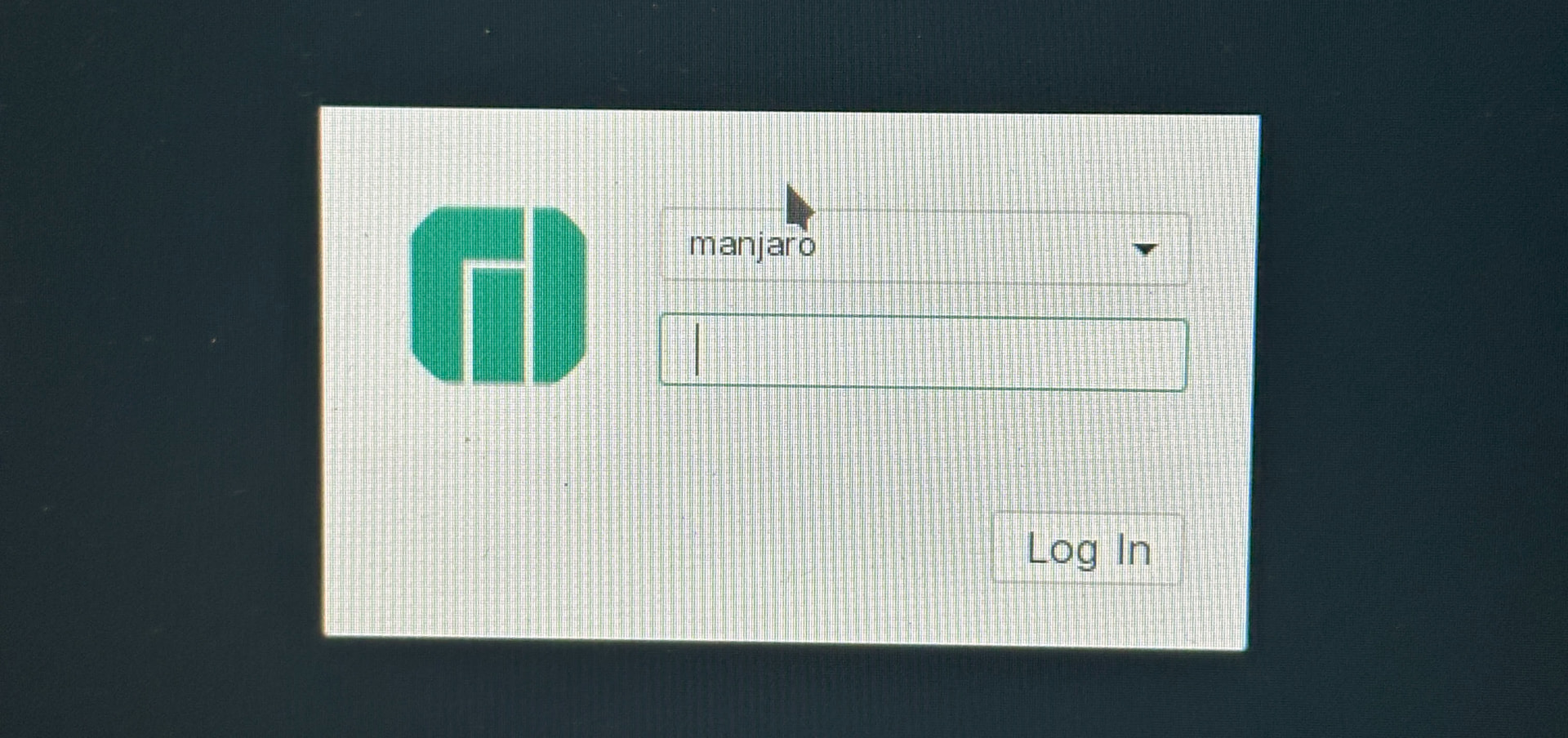

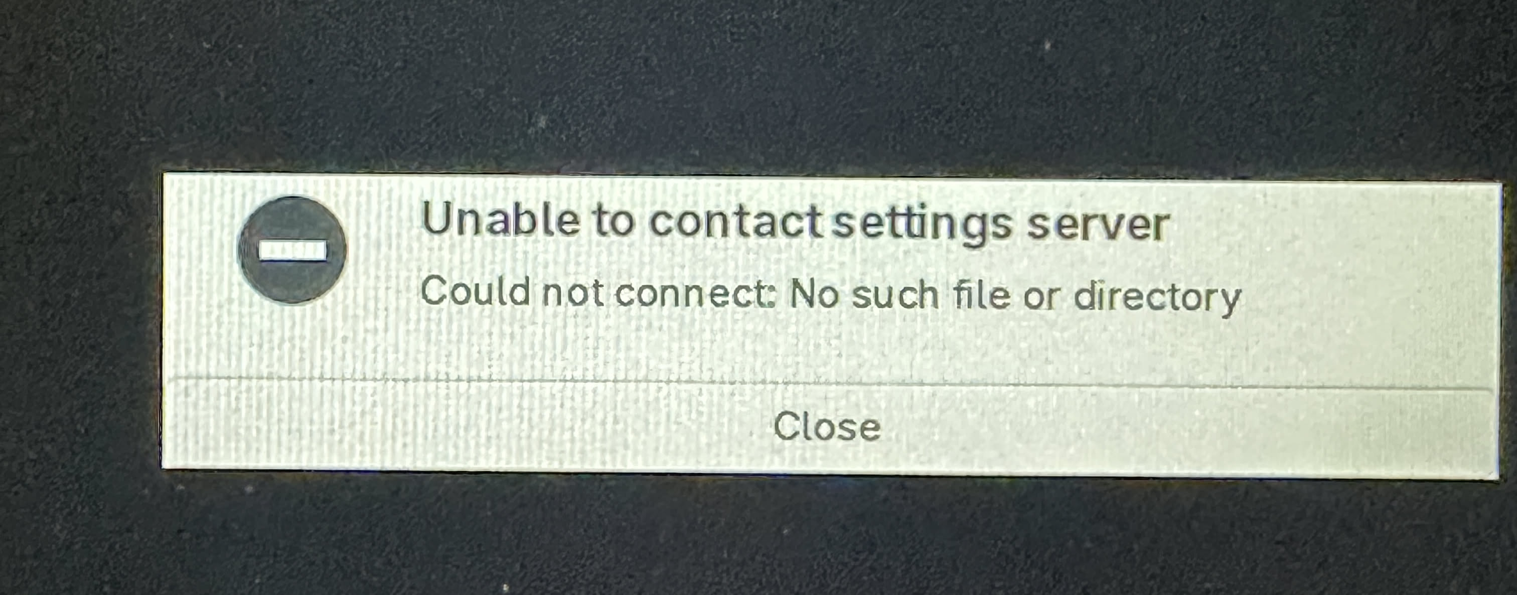

I downloaded the manjaro-xfce-26.1-testing-260719-linux71.iso and in my testing VM, it booting into the desktop flawlessly, rebooting in the VM, once again booted right into the desktop.
Copied the ISO to my Ventoy drive, and plugged in it into my Beelink SER, AMD Ryzen 7, 5800H, booted into this screen
Decided to bypass Ventoy and wrote ISO directly to a USB drive, booted into same error message. Only way to bypass this error was to use Ctrl +Alt+ Back, then it took me to the login screen, where I could enter the manjaro password, and it took me to the desktop.
Also tried it on my HP Probook 6570b laptop, same scenario, although the time it took for the password to work was considerably longer, like 2 minutes.
Did you test both variants? The one manjaro-live was run at build-time or the one with user creation on build-time? Which exactly did you test? Both releases have the same file name!
Not the minimal, only the XFCE testing (4.8GB).
Read my questions and answer correctly! Both ISOs were created one hour apparent.
I did not catch that… I tried the …757, I will try the …707.

xfce-26.1-testing-minimal-260720-linux71.iso
First boot:
no autologin gives the poup what DeLinuxCO showed earlier… Then let me in for the first try
Hungarian kb layout is set correctly in the DE.
Second try:
Cant even let me in, check video.

xfce-26.1-testing-minimal-260720-linux618.iso
gives that msg what showed by …
4-6 times wrote the manjaro password, then let me in, Hungarian layout in DE.
