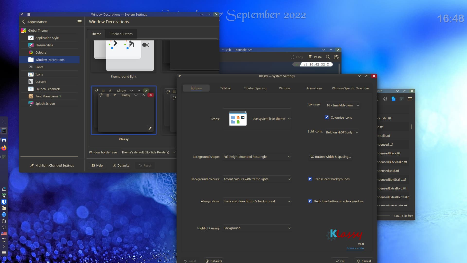

I recommend you install and take a look at klassy. There are good settings to make it work the way you like (including button shapes, colours, transparencies for active/inactive and MUCH more… It’s crazy)
pamac install klassy-git
Wow, it’s rather nice - just played with it for ten minutes myself. I like narrow titlebars - it’s nice to have a setting for reducing the padding, and have ‘red’ close button only on the active window - some great options there.
Adjustable ‘round corner radius’ - can do square or round.

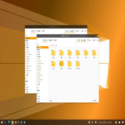

Im using WinConceptOS (around 14k users actually), when i click on “get New Window Decorations” and look at WinConceptOS i dont see any details about modification.
https://store.kde.org/p/1377756
https://github.com/yeyushengfan258/WinConceptOS-kde
