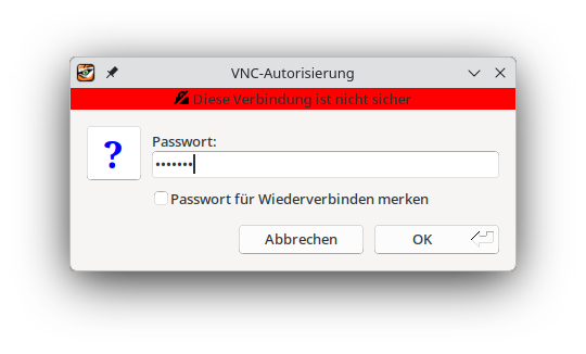

When I try to connect to my Android phone I will be prompted to enter my password. Below the password field, there is a checkbox with the option to save the password for future connection. I can check this option but it has no effect, the password will never be saved.
is this a bug or is an option in the options dialog not set.

On my system the option states Keep password for reconnect.
I don’t see this as a persistent configuration option - it is only valid for the current connection.
In the context, I understand this as - keep the password so in the event the network connection breaks - attempt to reconnect using this password.
No - I think it is per design.
If you want to save the password across connections - you can use Remmina or Krdc.
I have done some investigations and have concluded that the specific vncviewer dialog is for the current connection - and is only used if the network connection break.
Using a remote connection management utility like Krdc on Plasma and Remmina on GTK you can instruct the connection manager to store the password. The password is then saved in the system’s keyring or wallet.
