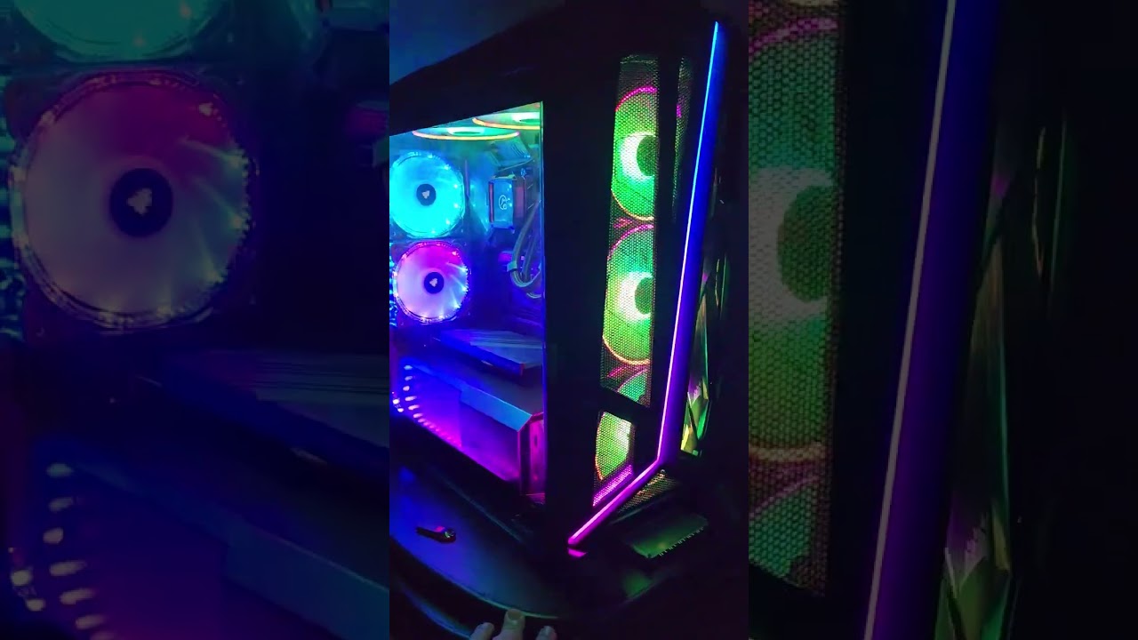

First part of the video the LCD display works under Windows.
The second part under Linux - you can notice it in standby having a screensaver preloaded. Wondering where I can find and change that screensaver…
Also notice how powerful is openrgb when under Linux :slightly_smiling_face:
It may be hardcoded in the firmware. Screensavers change, but that doesn’t seem to change at all.
