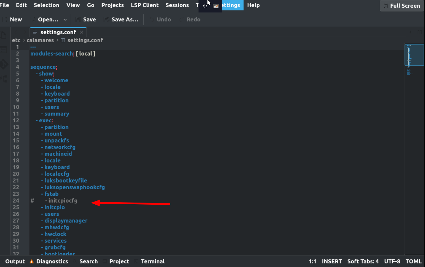

What mode of operation of Calamares do you use, the usual unpacking from an ISO image?
This my calamares settings.conf
I had to comment out -initcpiocfg otherwise I would get an error in the install process

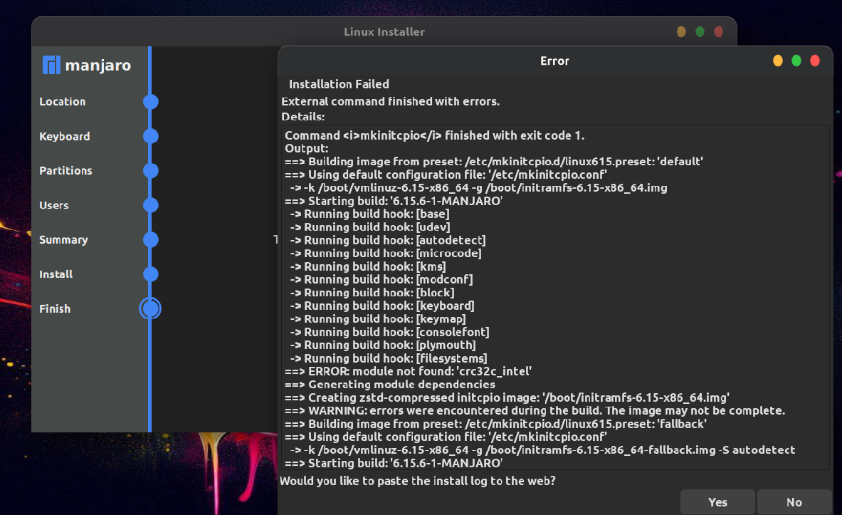

This is the error with -initcpiocfg
If you use the regular calamares package and disable -initcpiocfg , you get this error during installation

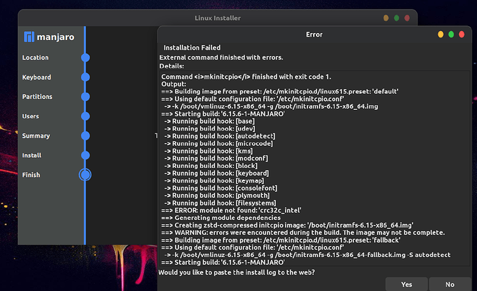

Error without -initcpiocfg

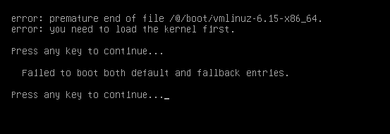

I tried the calamares-git package and disabled -initcpiocfg , in this case the installation is successful but the installed system does not start and gives this error
Error: premature end of file
