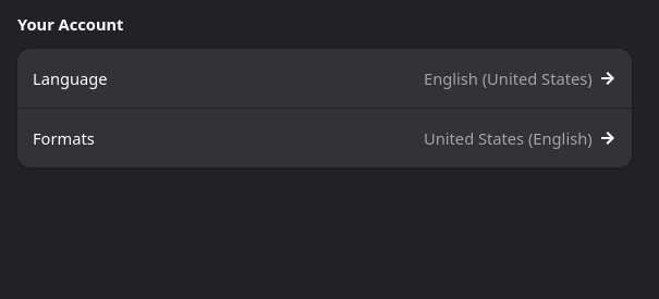

At Gnome Environment, in the Settings > System > Region & Language > there are two options Language and Formats. Please check if Formats is in English. There will be “United States” and “United Kingdom” too among others.
:vulcan_salute:
yes, already English
Have you tried switching Formats to “UK English”?
i changed it to UK (english), and it fixed it. then I changed it to US (english) and it retained the fix.
