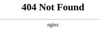

The default connectivity check URL gives a 404 error, causing NetworkManager to claim limited connectivity
As the title says, the NetworkManager connectivity check URL now gives a 404 error, so the network icon in the panel shows a question mark and claims there is limited connectivity, even though the connection actually works. Please replace the file check_network_status.txt on the server, or change the URL to one that works.

The question mark is gone from my network icon in the panel, but I still get a 404 error when navigating to http://ping.manjaro.org/check_network_status.txt in firefox.

This morning there was a question mark and the warning that I had limited connectivity, even though my Internet worked fine otherwise. I tried to manually retrieve the connectivity check URL and got 404 Not Found. Later this afternoon, the question mark and limited connectivity warning were gone. I still get the 404 error though. Now I don’t think the question mark and limited connectivity warning are related to the 404 error.
Pretty sure 404 with a browser is by design. It is not supposed to be html. But the server answers and that is what matters. Dns/isp problem seems more probable.
As @anon33601770 said.
Even a error 404 is a valid response. The webserver itself is reachable, but there is nothing configured on the given URL.
If you have limited connectivity, the message would be a different one. An error is not related to your question mark.
See this, it explains why 404 is given as response. It is not an error regarding network connectivity, but due to a not properly configured site.
An error 404 is configurable by the owner of the website and can show also something different. What you see on the URL you posted is the default page, nothing else.
You will see the error also if you try to reach any website on a server which doesn’t exist.
The most important message is the second sentence of the article
" is a hypertext transfer protocol (HTTP) standard response code, to indicate that the browser was able to communicate with a given server, but the server could not find what was requested."
Your browser is able to communicate, but there is nothing configured on the URL. Which means in fact, that your network is not limited.
If it would be a DNS or ISP problem, the message would be a different one. Error 404 comes from the web server, not the browser. 404 is HTML, but in most cases a generic one created by the web server.

I think you’ll find it was suggested the initial problem was likely a DNS issue. The mention of 404 was a separate issue. It seems like you confused the response from @Teo . :slight_smile:
I initially thought the 404 error had caused the limited connectivity warning. That was proven wrong. The 404 error is a non-issue, as long as NetworkManager still knows that I have Internet access.
Whatever caused the limited connectivity warning resolved itself a few hours after I made this post.
I was referring to the initial post where these two issues were related by @ben75:
Yes, but you quoted @Teo;
what follows is usually a response to the quoted text.
Nonetheless, I think we’re all in agreement that the 404 was unrelated to the initial issue. :smile_cat:
I am not sure why I had this very same error on my fresh install of KDE 26.0.4, but I fixed it by creating this file:
sudo nano /etc/NetworkManager/conf.d/20-connectivity.conf
and enter the following two lines of content:
[connectivity]
uri=http://nmcheck.gnome.org/check_network_status.txt
which gives to me (also in the browser) not a 404 response, but the text “NetworkManager is online”.
