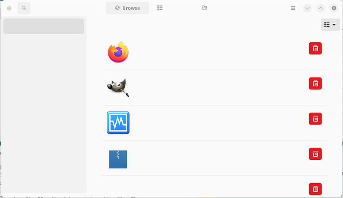

I recently applied the plasma 6 upgrade. I now have no text showing in Add/Remove Software -
Is this fixable?

That’s the pamac GUI, which is written by way of gtk. It is therefore unrelated to Plasma, which is built upon qt. However, the change from Plasma 5 to Plasma 6 will probably have had an effect on the color scheme being used by gtk, so I would advise you to select a different gtk theme.
Open up System Settings and navigate to… ![]()
Appearance & Style → Colors & Themes →Application Style → Configure GNOME/GTK Application Style
Installing pamac-gtk3 can resolve similar issues.
sudo pacman -S pamac-gtk3
This should prompt you to replace pamac-gtk (4).
Whether this will solve you issue, I can’t say, however, this can be reverted easily using the same procedure pamac-gtk.
Thanks! That fixed it.
