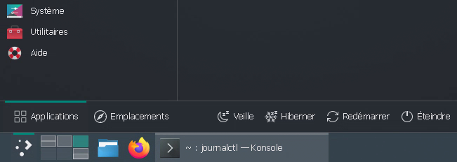

Here is an example of what it’s like with a maximized window:

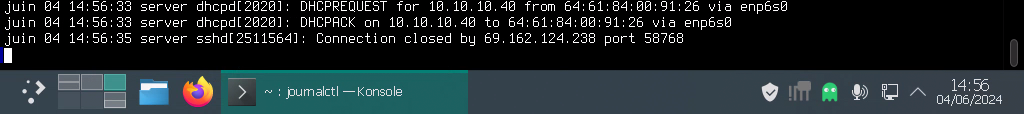

And here is what it looks like on an empty desktop:

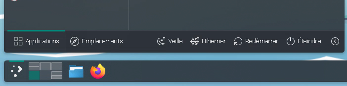

The same effect is also seen with the launcher menu that I get by clicking on the leftmost button:
