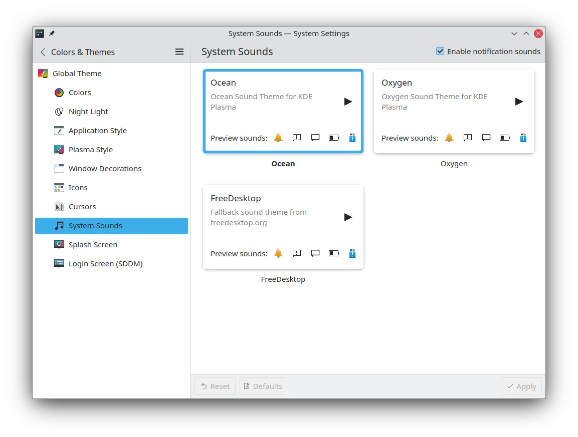

Hello everyone, I noticed a long time ago when I used the test version, and now I switched to the main one, that in all other distributions the system sounds are fine. Three blocks (if I remember correctly), and all sounds turn on. In Manjaro, the charging sound is destroyed, and there are only 2 blocks. ISO Manjaro Linux 24.0 Wynsdey was also released and I thought they would definitely fix it, but everything remained the same. Let’s see how to do this so that Manjaro 6 plasma becomes the way it was intended)

There is a theme, but no sounds, and this is the default in the new ISO release

Getting the same error as OP when trying to play the battery sound - “File or data not found”.
System sounds changed for me with the latest stable update. Which one where the default ones before?
Select Ocean sound theme and apply it, that FreeDesktop is incomplete and is considered as standard fallback.
I’m already using Ocean, but these are different sounds. I’d like to have the default from pre-update back.
Ocean already has battery sounds

It appeared, but the charging sound error appears in FreeDesktop, while as I already said, it has full sounds in other distributions of Ubuntu Plasma 6
FreeDesktop sound theme is the standard sound spec from FreeDesktop, and the official one required by Plasma desktop is the same one compiled by Arch and has no battery sounds.
If other distros have battery sound for FreeDesktop then they surely modified it.
To add to that…
The sound-theme-freedesktop package comes from Arch, and Manjaro has not modified it.
