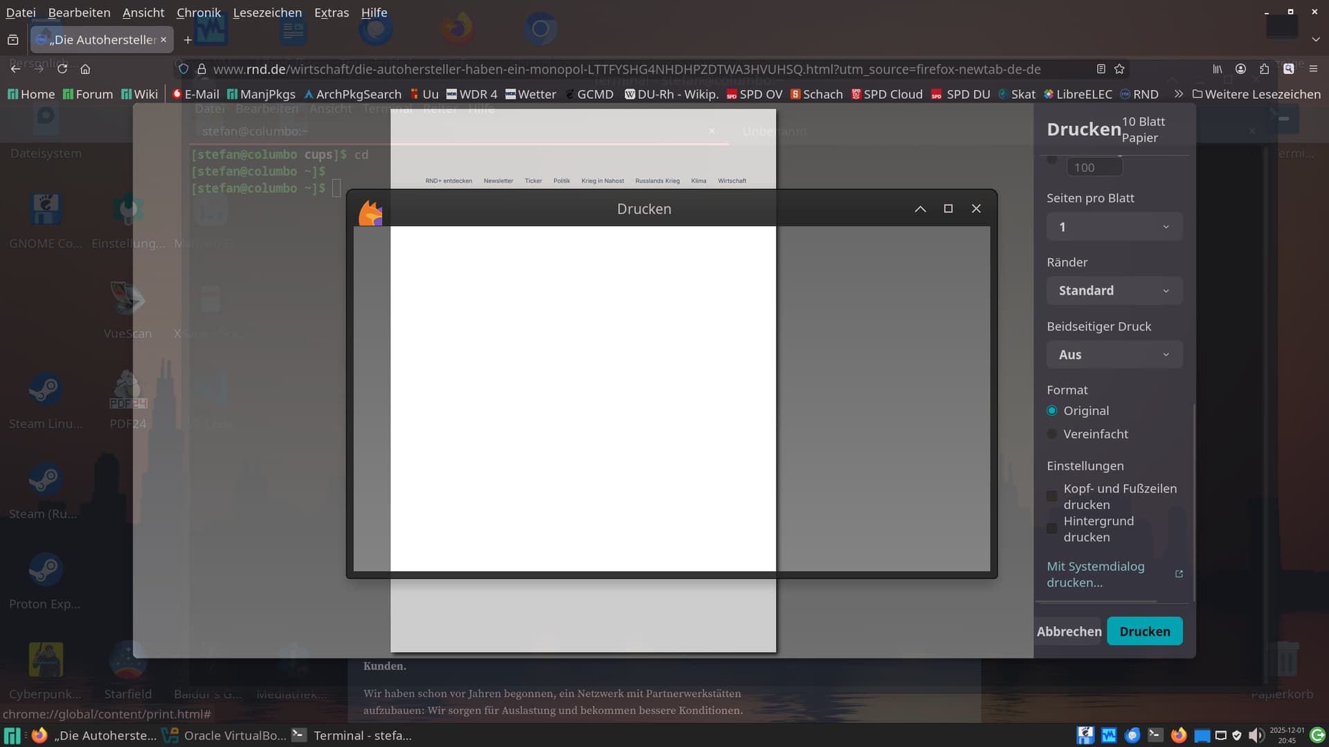

Hi there,
since
$ pacman -Q cups
cups 2:2.4.15-1
printing using the system dialog is no longer possible - the windows freezes and when closing the corresponding app terminates.
LibreOffice printing is not affected.
Any hints please?

Okay, it’s unstable, can I roll back?

You can roll back, if you wish, e.g.:
sudo pacman-mirrors --api --set-branch stable
sudo pacman-mirrors --fasttrack 5 && sudo pacman -Syyuu
Okay, this is good news in case of major failure. :slight_smile:
What if I’d choose to contribute to bug hunting?
You might start with switching to the Testing branch – If you’re now in Stable branch, substitute stable for testing in the previous example given, and use sudo pacman -Syyu to upgrade after switching.
Okay, I’ve done this - and printing is fine with this version.
Okay, the latest version from today works fine now: cups 2:2.4.15-2
