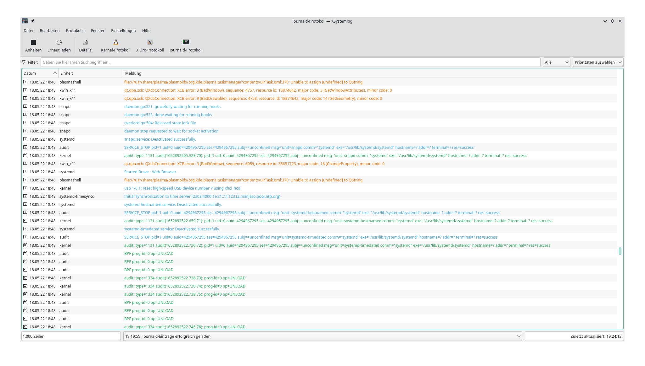

open the ksystemlog application and check if you dont have spam in logs

what do you mean with spam in logs? I’m new in linux.
with spam i mean a lot of the same logs are repeating

it doesn’t seem that spam logs are existing
just to be sure can you post a screenshot of it
uploaded a screenshot, but there are more than 1000 logs.
looks good, no spam
