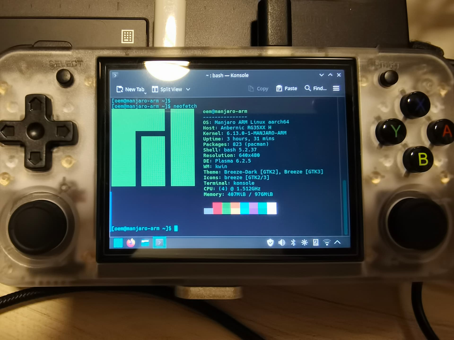

it can’t complete the installation because it doesn’t meet the minimum hardware requirements,
or more precisely because of insufficient RAM (there are only 976 megabytes)

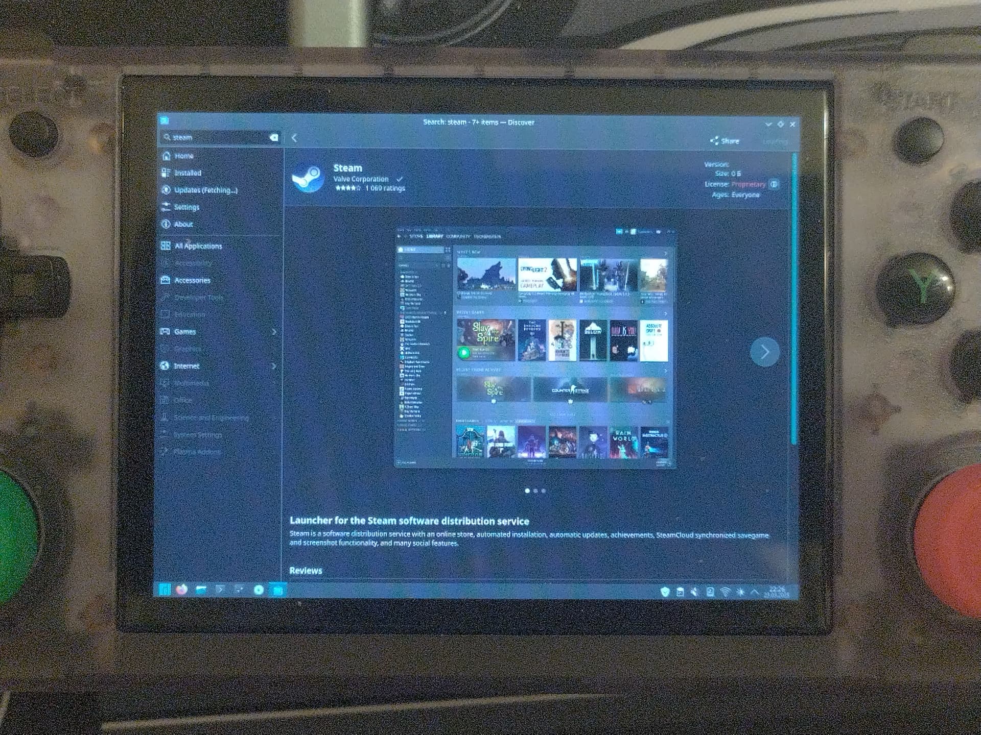

  3. If I install the steam launcher, I can assign the sticks to the console as a computer mouse, but the first attempt to install it via pamac also failed, it gave an error (target not found), although I removed the hashes from the [multilib] repo to make them work.

  2. I’m not sure if steam is there for arm64 architecture , so it would require box64 to run. It might be easier to install it by downloading it from the website

Regarding downloading steam from the site, they only give a deb package
it is in discover but there is no use for it
I added the package here, but it won’t run because of the 32bit libraries dependency.

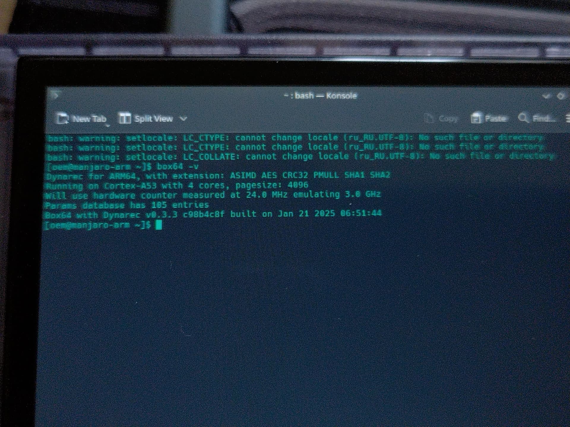

UPD2: I added a box64 application with box32 support
I installed box-64 I’m checking the package from your disk now, only Firefox is too heavy for it

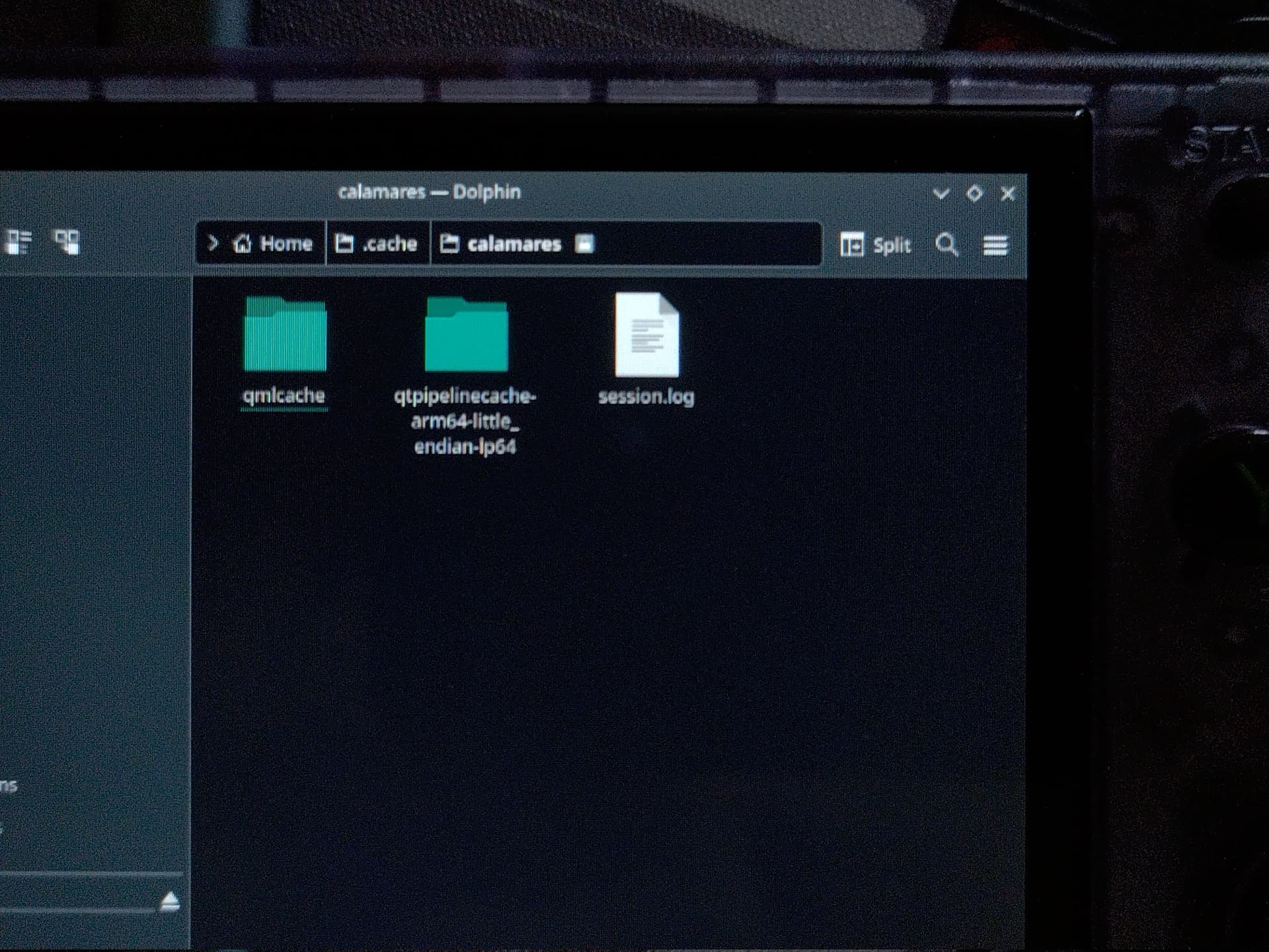

I also found that the installer that works on Calamares breaks because it uses more than +1GB of memory.
It can be limited to 0.7GB to make it work on an arm device that only has 1GB of RAM, but I don’t have a config folder where it should be
and yes, I checked the steam build, from your disk
I have a dependency error

Should be:
[oem@manjaro-arm ~]$ box64 --version
[BOX64] Box64 with Dynarec v0.3.5 d3d3fa25f built on Mar 24 2025 08:47:59
The problem with calamares is known to me, but I haven’t looked for a solution yet.
I couldn’t get steam to run as only a 1GB device is available right now
UP: Looks like the steam is working and the problem in the low RAM.
