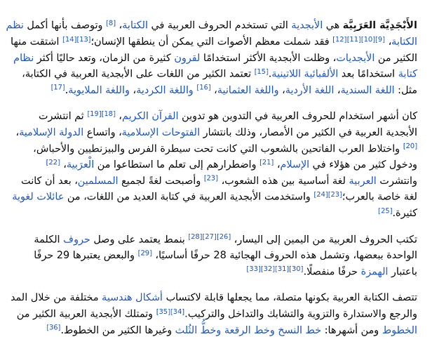

This is the default Arabic font:

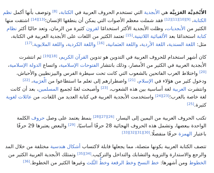

It should be something like this:
The default Arabic font installed only on Gnome version is not really usable for reading. On KDE, the default one is perfect.

It’s all about type of font. The default one on Gnome is not readable. On the other hand, KDE default Arabic font is great. So, I am asking why the default one on Gnome is not like KDE or even other distros.
So what is the name of the font used on GNOME, as opposed to the name of the font used on KDE.
…and what’s the application in the screenshot?
The screenshot is from website Wikipedia. It’s the same font on all the device apps.
The installed Gnome font: Nastaliq or Persian font.
The font that should be installed: Naskh font.

Installing this font worked: ttf-dejavu

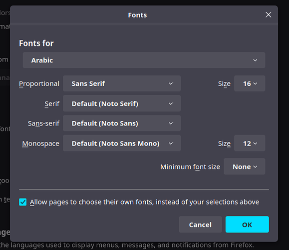

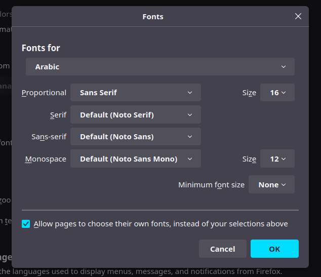

First, check if you have changed font settings for Arabic in Firefox:

  1. For the system Arabic issue: the vanilla gnome font is Adwaita and changing it to Sans makes this issue in system apps like File Manager.
  2. For Firefox: the default font for all languages is Dejavu which I’m not installed on Manjato by default and that’s why when I installed it everything worked fine.
So, AFAIK, all need is dejavu to be installed by default with other packages.
