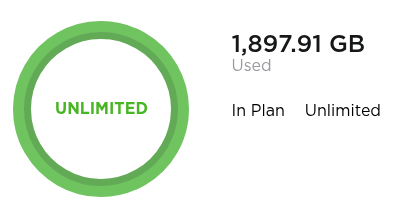

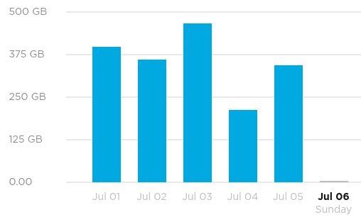

I have a data limit on my internet access, and my 15 year old son keeps going over it… DRAMATICALLY. I need to teach him a lesson, because he’s not listening about correct management, and I need him to realize he’s reached his limit.
I get up to 5 TB per month (before getting throttled down… Yeah, that’s my ISP
s definition of unlimited), but he’s going to finish that off by the end of the week.
