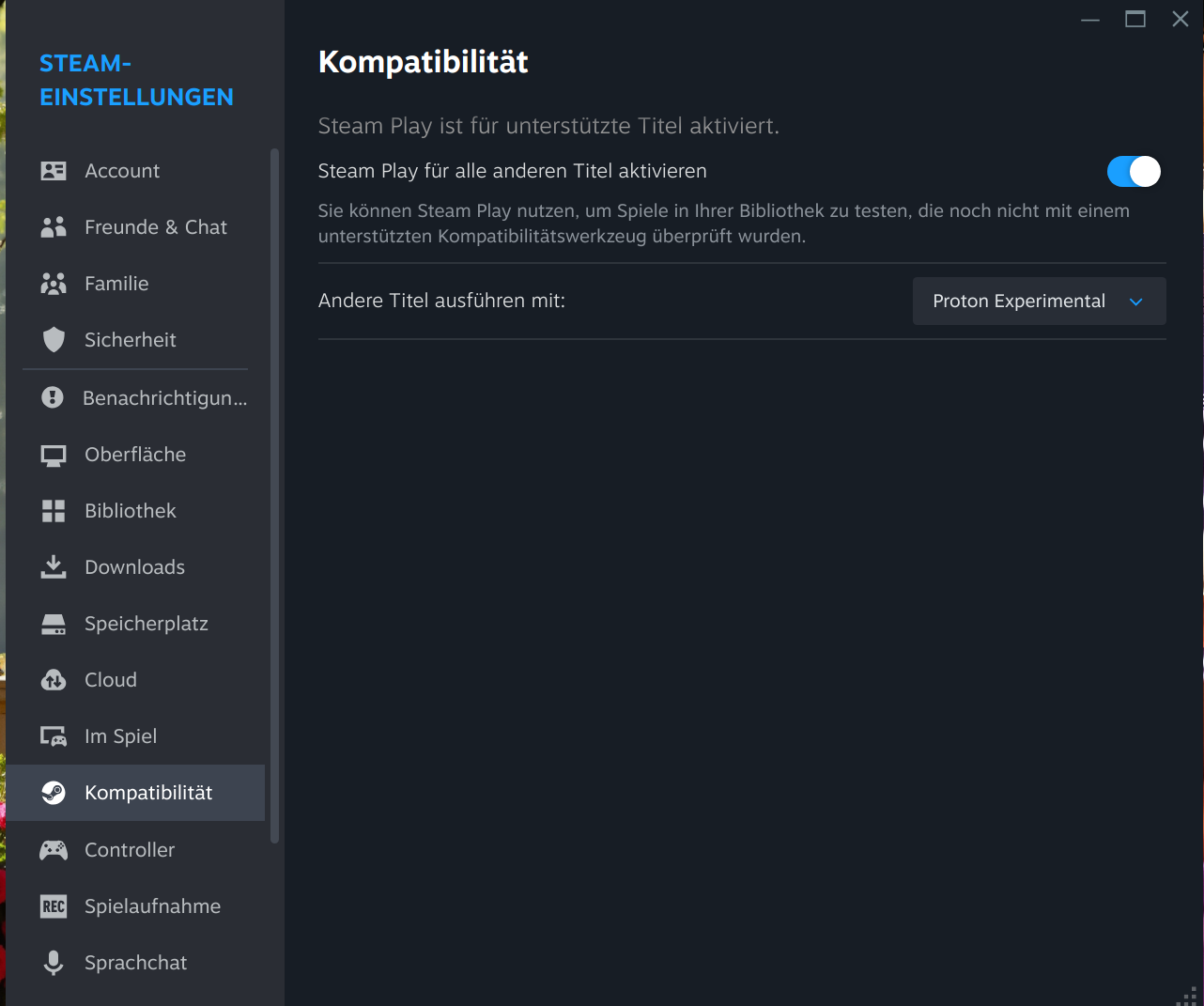

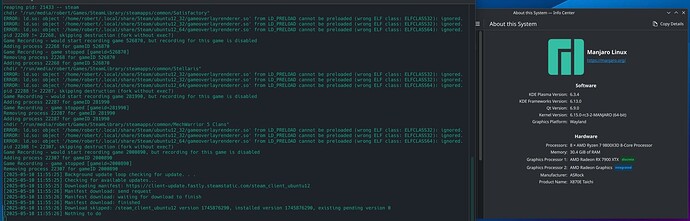

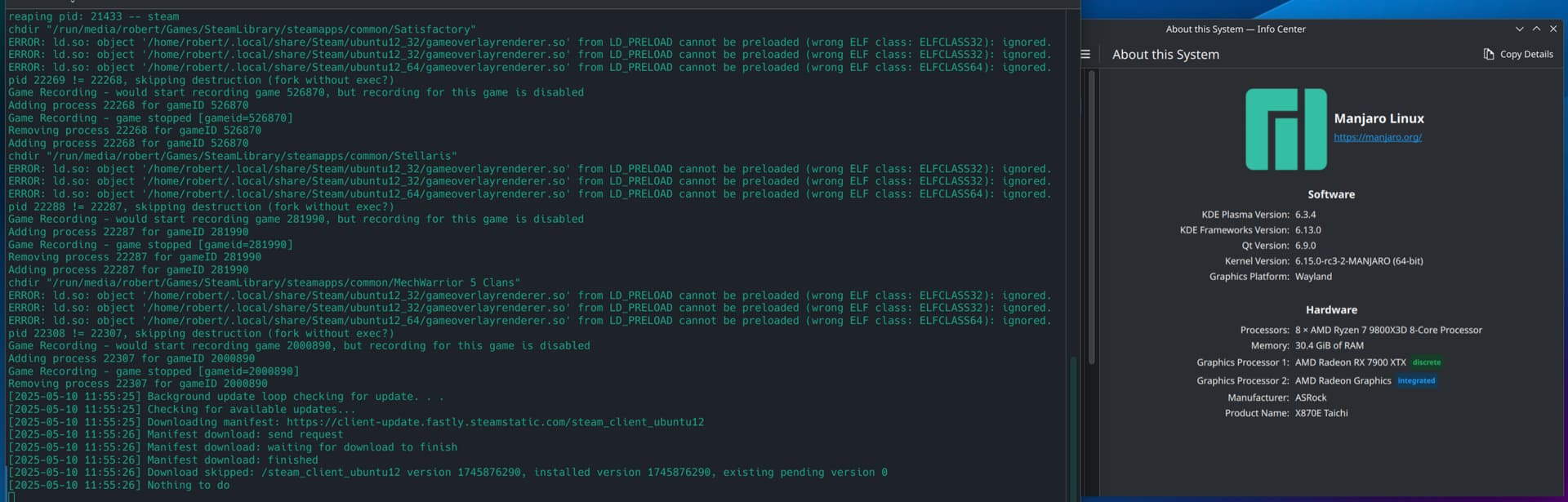

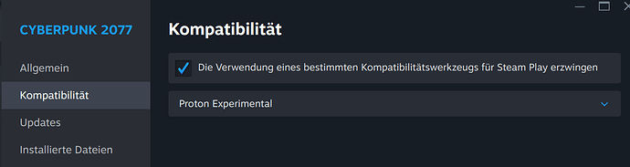

Been driving KDE Manjaro for 5 months now no issues. Really none. The other day I updated to 6.15 kernal everything was great. Worked fine for a couple days. Yesterday I decided to try and install Gnome. So I downloaded the latest ISO. Was not good for me. This morning I downloaded the latest KDE ISO again and installed it. Got everything to where I was before I left. Went to jump into a game. No matter what Steam will not launch the game. Button turns green and instantantly closes. Sometimes if its a new game I will get the Vulcan shader windows for a bit then it closes and the game never launches. I have tried like 4 different versions of Proton. I don’t know what to do.

Also inxi -zv8 shows a lot more information than KDE’s system information, which could help those trying to help you.
Without more info, my guess is steam might be using the integrated GPU instead of the discrete GPU.

Here is the whole steam start up. I see both GPUs.
