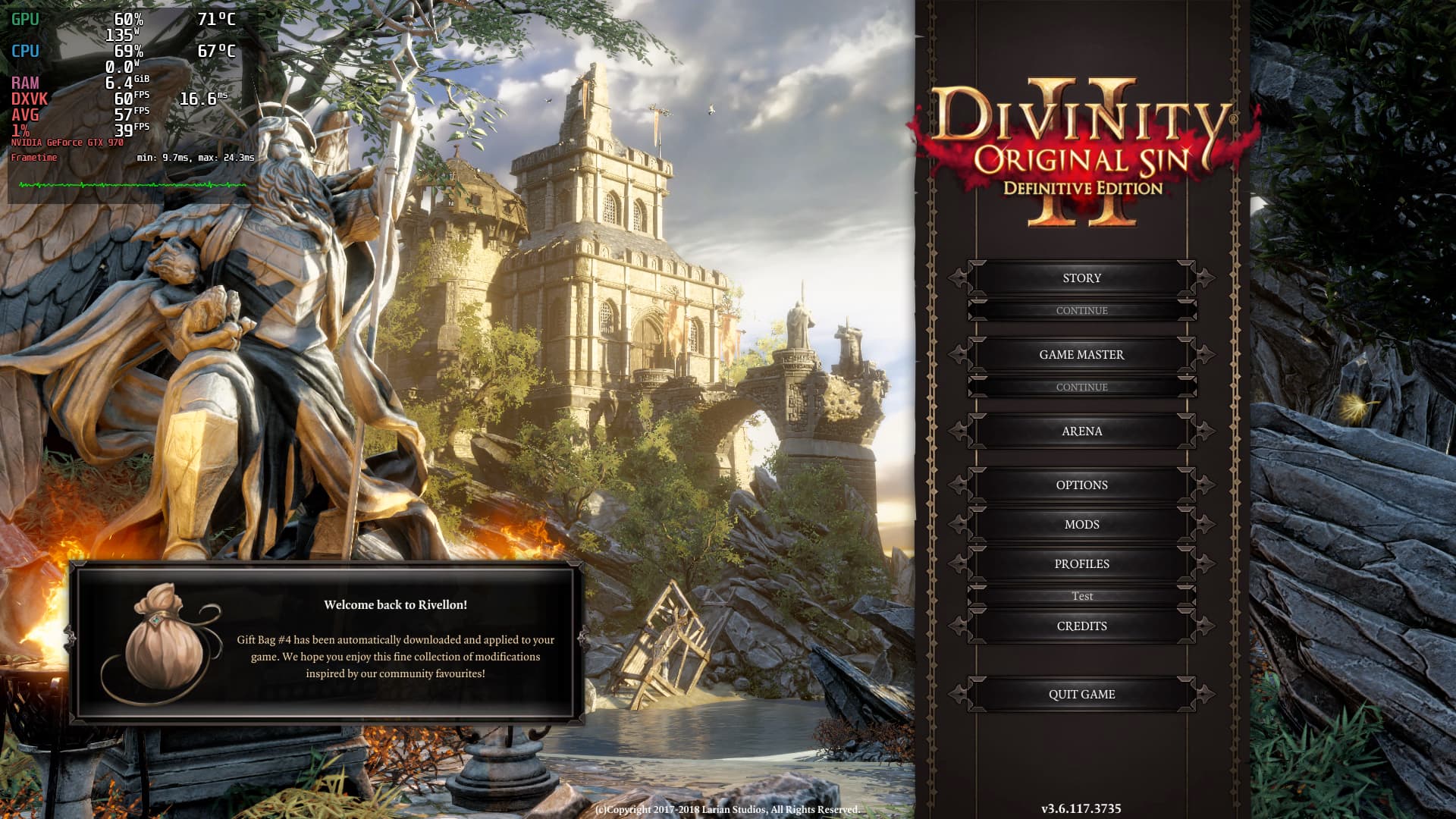

Either driver version should in theory work fine. Though if I were on the Gnome or KDE Plasma desktop using wayland display server, I’d be inclined to go with the newer version in the hopes of better Wayland compatibility. I chose the 570xx driver using XFCE on X11 display server and it has been great. I think I even gained a little bit of performance in gaming.
