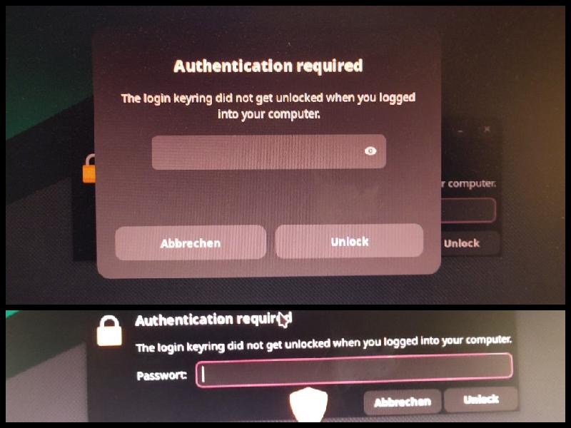

Since the 2025-12-15 Stable Update I encounter two issues that are not critical but annoying, as I have not found any solution to make them disappear.
1/ Every boot process comes with a new warning on unability to resume from device
“Unable to resume from device ‘/dev/disk/by-uuid/b8f…’ (8:2) offset 0, continuing boot process.
2/ I get two separate Authentication required screens in sequence

1/ Have you checked your pacnew files? From 2012-12-08 Gnome X11 was removed and hooks in /etc/mkinitcpio.conf probably needs to be updated. I don’t have Gnome and have been running wayland for some time so just a guess.
I assume the warning come from having resume= in Grub entry but the computer is not sleeping and hence is unable to resume (a wild guess, I am far from an expert), so there should be a hook or order of hooks to change.
2/ Do you use encryption? There is a similar discussion further up this thread. If you think it’s a kernel issue, which kernels have you tried?
