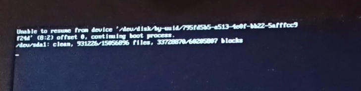

update worked - initially rebooted to gnome, I could set it back to plasma/wayland on login …
however still getting this startup error:
anything to worry about?

Maybe check this: Failed to stat resume device - #2 by Aragorn
Make sure the UUIDs match for your swap partition and the cmdline in /etc/default/grub:
cat /etc/default/grub | grep CMDLINE
sudo blkid | grep swap
… also, make sure resume is included in the HOOKS= line in /etc/mkinitcpio.conf.
