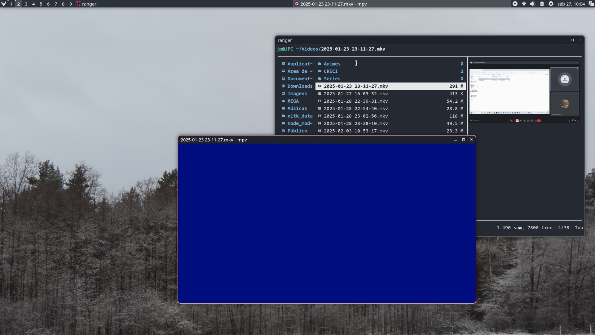

Playing files in MPV (v0.40.0) gives me a blue screen (with audio)
OS: Manjaro up-to-date
Kernel: Linux 6.12.48-1-MANJARO
WM: awesome (X11)
GPU: Intel UHD Graphics 620 @ 1.10 GHz [Integrated]
GPU: NVIDIA GeForce MX250 [Discrete]

Solved by using a different video output
For a list of available video outputs:
$ mpv --vo=help
I’m using xv
