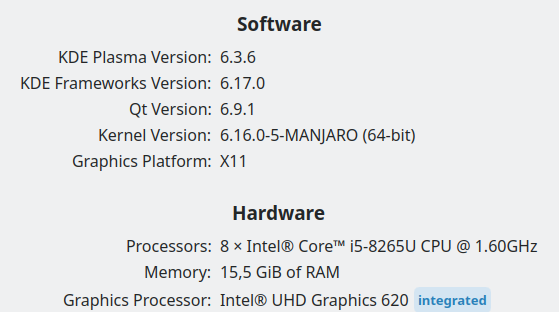

For some reason, Kwin is crash looping for me on X11 after this update… I’m not sure how to fix it. Does not happen on Wayland though…
