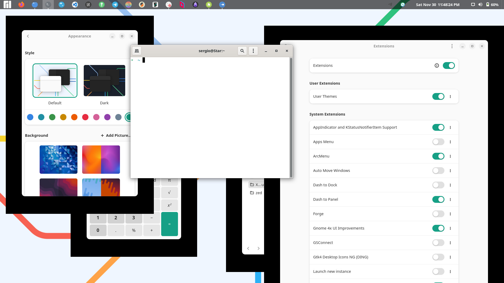

After the update I had an issue with Gnome having these giant black borders around certain apps. Default Light Theme (happened in dark theme too)
This fixed it https://www.reddit.com/r/gnome/comments/1fsf6wz/thick_black_borders_around_some_windows/
