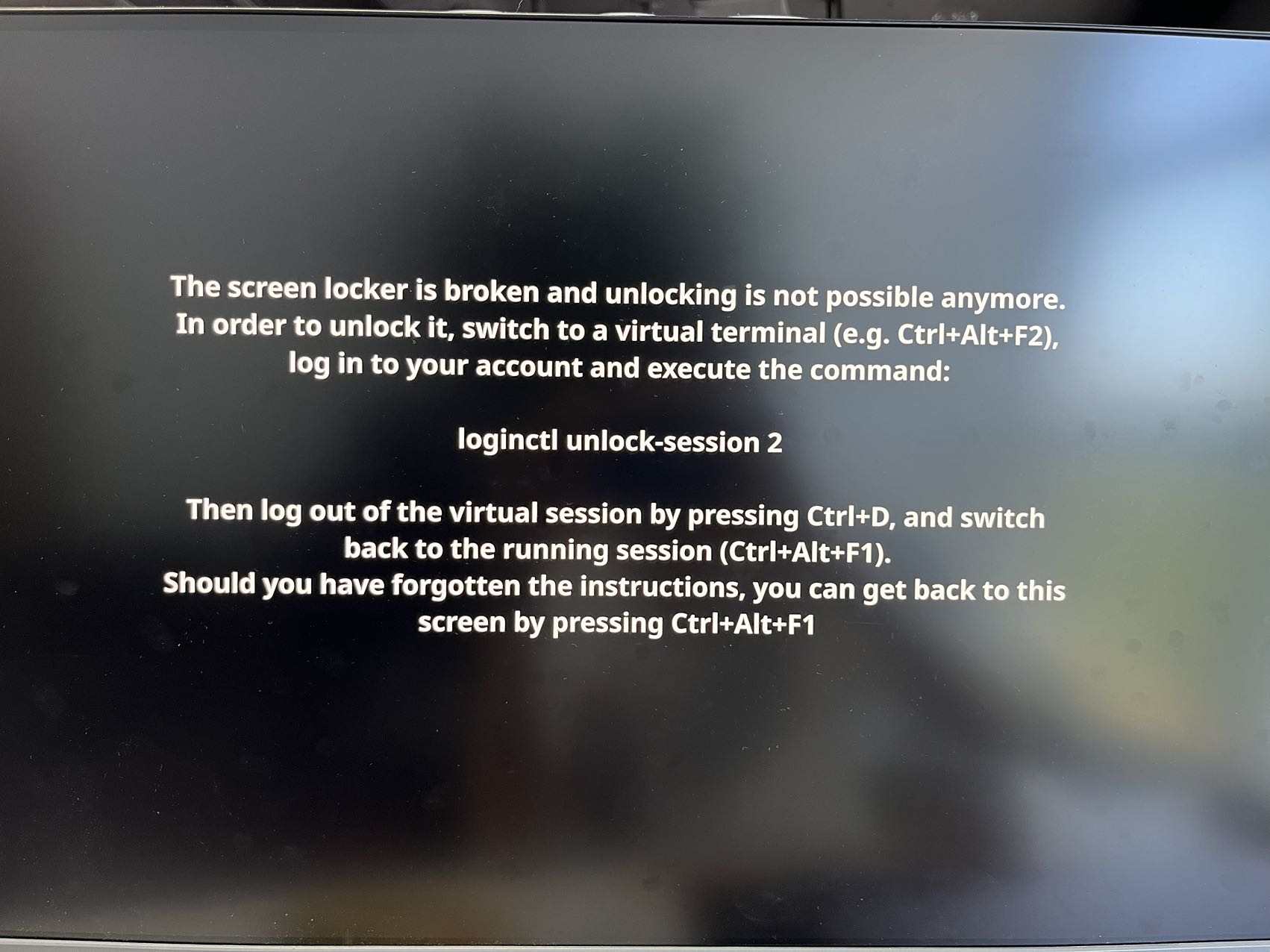

Got this black background white letters screen after lunch pause:
Simply meta+L to lock and re-login doesn’t recreate the bug, I guess it requires a longer time. I’ll report more info as it occurs more times.
2024-07-18 Update: seems only occur in wayland, x11 is fine

Update: So, writing this brought me back to the refresh rate and that I said the Laptop screen really wants its native resolution. So, I double checked and noticed that the resolution was not at the native one anymore. I set it back and it is working.
This breaking might have nothing to do with the update, but some accidental change to the resolution.
That occurs quite regularly on my PinePhone Pro. Rather inconvenient since I don’t have the convergence dock so can not connect a keyboard.
However, when KDE Connect actually connects to the thing, it’s possible to unlock it remotely.
I’ve only seen this happen once on the laptop — in a Virtual Machine with Manjaro KDE “Testing” branch.
Worth creating your own thread for? :wink:
