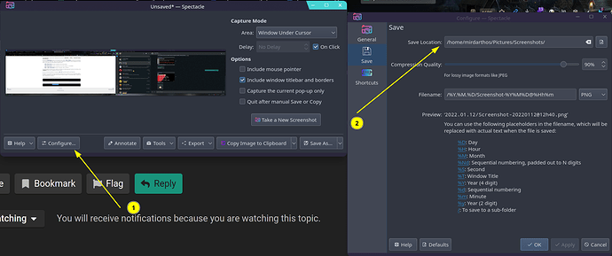

Hi @RomanPerekhrest,
That looks like a permissions error. Make sure the location you’re trying to save it too is writable by the current user.
Edit:
Edit/confirm by opening spectacle and checking its configuration:
  1. Click the Configure button.
  2. In the window that pops up, confirm the “Save location” path. Ensure it’s set to somewhere you have write access too.
Hope this helps!
