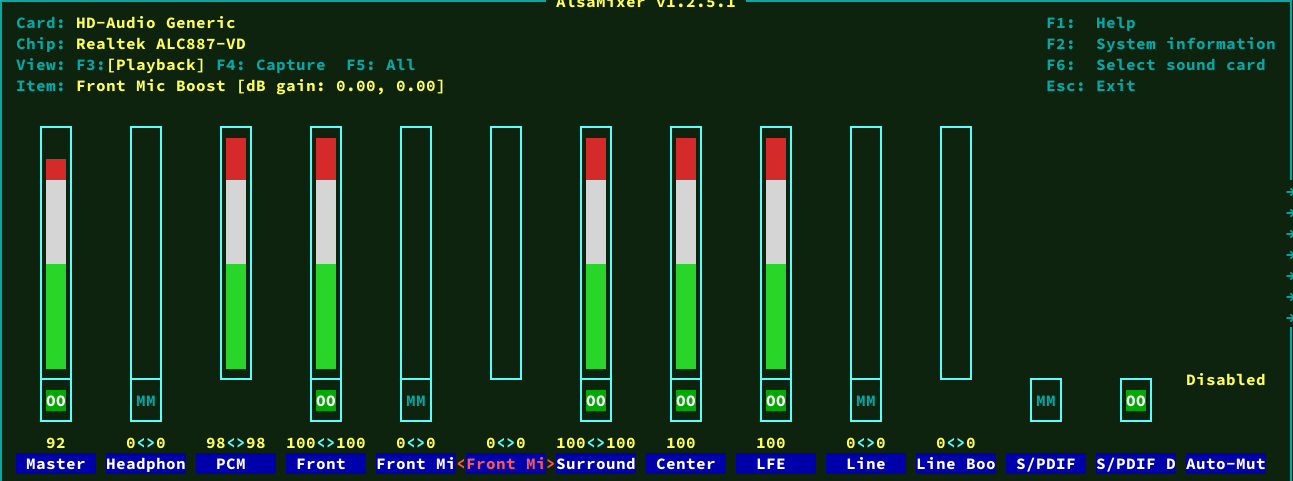

Run alsamixer in a terminal (not on the VM), press F6 to select your sound card.
You should see something like this.
MM means muted, so no audio. If it is MM:
  • Use the arrow keys to move the selected channel to the muted channel.
  • Press M
  • Now use the up arrow key to increase the volume or press a number key.

This is what alsamixer gave
It also says dummy output in sound settings!
As I mentioned the speakers/sound card is not identified.
Its says no sound card on pressing F6.
