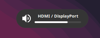

Hi.
Yesterday I connected my laptop to my TV using HDMI. I changed output to the HDMI port. Now that I’m not connected to the HDMI port, internal audio isn’t working, and I can change the output using the gnome settings. When turning up or down the volume it shows HDMI, but it is not connected. The only way I can get the speakers to work is by plugging and unplugging headphones in the output jack. I’m suing Pipewire and the inxi -Fza output is as follows

I did it and have had fixed the issue, but then I connected again to the HDMI and the same thing happened.
Hi, did someone find a solution to this problem? I have the same issue and cannot figure out how to fix it
Likely you had same issue as OP and I, might have both pulseaudio and pipewire installed;
run sudo pacman -S manjaro-pipewire and it will prompt you with conflicting programs - allow it to remove the pulseaudio files and then install and restart. Worked for me!
Same thing here on my laptop Dell Latitude 5420.
I have only pipewire installed.
I have to connect HDMI again, switch the audio output to speakers and then unplug the HDMI.
