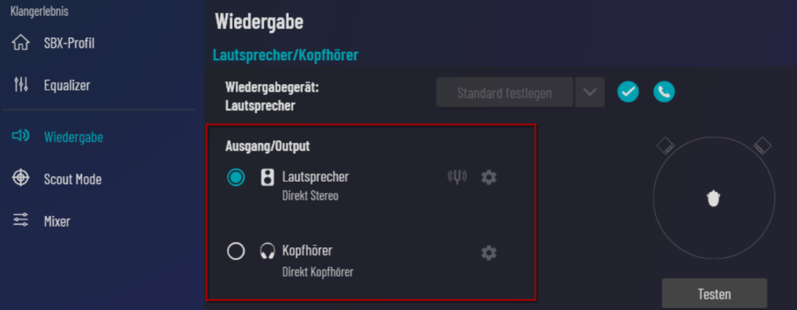

For Windows, the Sound Blaster Command Center software allows you to switch between headset and speakers.
Is this also possible in Manjaro? I have not yet been able to find a way to do this, no matter which output I select, it is not possible to switch between headset and speakers. As a workaround, you always have to connect or disconnect the headset from the socket, depending on what you want to listen to.
To all Sound BlasterX G6 owners, how do you do this or do you need special software to make the switching work as it does under Windows? In other words, without having to constantly connect or disconnect the headset.
