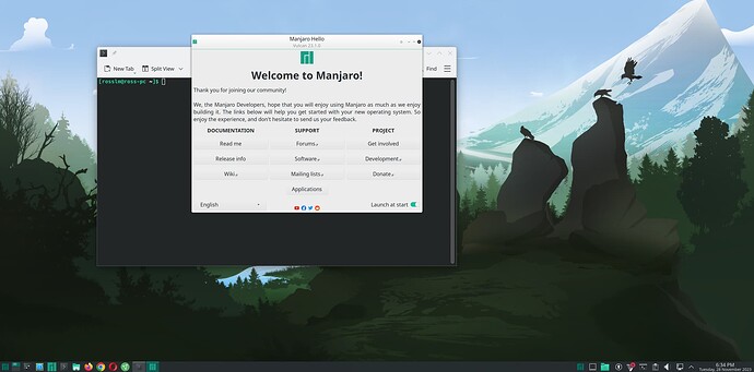

This happened around July, VMware workstation icons and text are microscopic. See attached screenshot Dolphin file manager is normal but Protonvpn and Manjaro Hello are miniscule. Any ideas welcome.
Dolphin and Hello look fine to me; even your VPN app seems consistent; apart from the button and ip address.
It looks like a scaling issue to me.
Check your settings.

The minimize maximize buttons on protonvpn and hello are 1/3 the size of dolphin buttons, I have tried scailng but this effects all apps so this is not a solution. As mentioned before mid year this was not the case. I even held the updates for a few months by rolling back to an earlier image to retain normal size text and buttons.

Yes, I see that now that I viewed the image fullscreen.
Are you using Wayland or X11? The reason I ask is that each have different scaling options, which might be worth experimenting with. I’m not using any GTK based apps, or, at least none that come to mind, so I’m unable to form a comparison.
