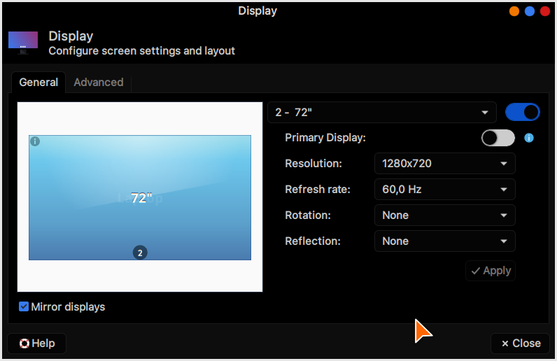

I’ve connected a second monitor: my laptop has a DisplayPort output, so I’m using a DisplayPort > HDMI adapter to hook the monitor.
In the Xfce’s preferences, I’m using it as “Extend to the right”.

As you can see, the laptop’s monitor is set to 1366x768 at 60Hz (maximum available resolution) and the external monitor to 1280x720 at 60Hz; I’ve set it to this lower resolution because between the HDMI cable and the monitor there is a recording device (AverMedia ezrecorder 310, which support a maximum resolution 1920x1080 at 60Hz, like the Samsung monitor) but GTA San Andreas doesn’t support such high resolution, so i set the game to 1280x720, also to avoid high CPU and GPU usage.

So, to set the same resolution and refresh rate on both monitors , I run, before to execute the game:
xrandr --output LVDS1 --mode 1280x720 --rate 60
These are the informations of xrandr after my settings:
LVDS1 connected primary 1280x720+0+0
(normal left inverted right x axis y axis) 310mm x 170mm
1280x720 59.86 60.00* 59.74
HDMI3 connected 1280x720+1366+0
(normal left inverted right x axis y axis) 1600mm x 900mm
1280x720 60.00*+ 50.00 59.94
