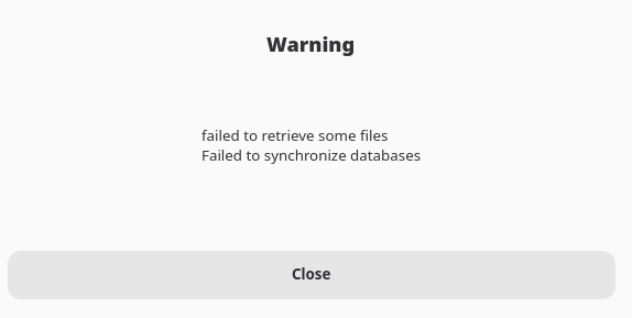

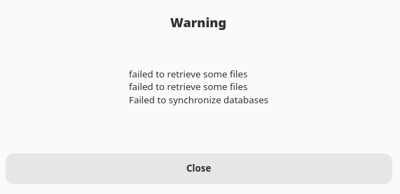

Software upgrade fails
When I try to do a software upgrade using the GUI, I get this;
Mod edit:- Images removed
Checked the forum for suggestions, and ran
sudo pacman-mirrors -f5 && sudo pacman -Syyu
at the command line; It downloaded 600 files (took 90 minutes) and then said that there was a corrupted file and nothing was upgraded. :face_with_raised_eyebrow:
Any idea what I am trying to fix and how to fix it? Thanks.
