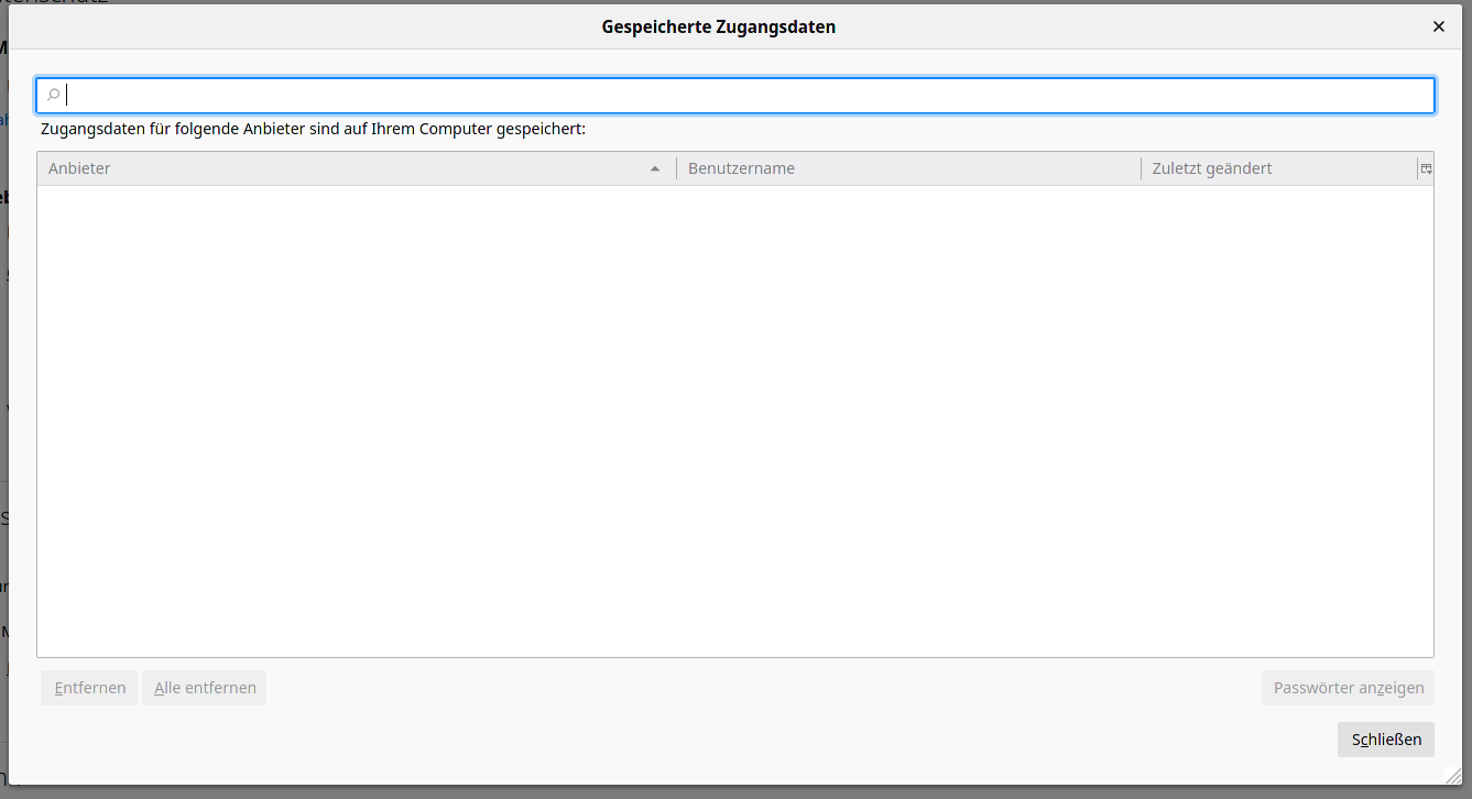

I cannot see my mail accounts here:
Some time ago - I think it was before the latest updates - all mail accounts where present. The passwords was stored and thunderbird didn´t ask for the mail - passwords.
This problem are with all different users and mail - accounts with thunderbird.
Can everyone help me to solve this problem :thinking:

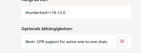

This looks weird, I do not see a failed libotr.so loading on my installation. libotr got installed on my system as an optional dependency of thunderbird-i18n-de.

I don´t know, if it is installed, because I cannot see it in pamac ?!?
libotr
I started thunderbird in safe-mode from the console. The password dosen´t stored in safe-mood too.
I see the same windows as in the first thread. No email accounts are visible.

I can’t tell from that screenshot either (not a pamac user). But it shouldn’t matter much, due to it being used for chat one time record messaging.
