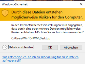

After your setting you still may have a problem to transfer your files from host to client. Here you will find the solution.
#x Disabling the Windows Security Warning for virt-manager over Samba
The warning message appears because Windows 10 identifies files transferred from your Linux host via Samba as a potential security risk. This is a standard Windows security measure.
1. Temporary solution
You can simply click “OK” to use the files despite the warning. However, you would need to repeat this each time you access them.
