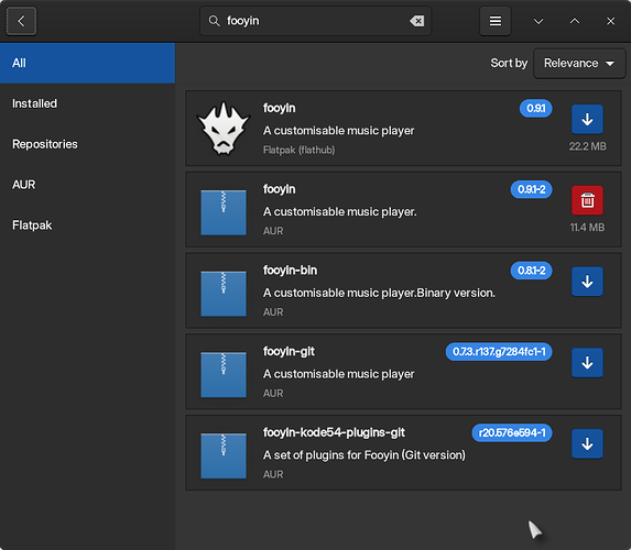

What packages are shown if you click on Flatpak in the sidebar?
Have you tried using flatpak search to “resync” Pamac GUI searches?
Absolutely no packages found… yet pamac search does find celeste with an ‘e’… I just don’t search for software in pamac-manager now, I use the browser and then install what I need without using the GUI; it’s a bit of a waste of space.
I have tried running flatpak search but it has no effect on pamac-manager searches.
@Ben
Checking flatpak search in CLI would discount the possibility of an error upstream
If you click Flatpak in the sidebar after using “cel” is the package visible?
If you continue typing package name, when does it disappear from Flatpak category?
more screenshots to confirm this might help maintainers
@viggy96
Gnome DE should be using pamc-gtk v11.7.3 based on GTK4
Ah yes, that’s what I meant. Yes I am running that version of pamac-gtk, 11.7.3-3.

This is why I run warehouse cause in the software store I was not able to find fooyin but warehouse had no issue.
I think you picked a VERY bad example… pamac-manager has absolutely no issues with that search:
Notice here that fooyin here is 0.91-2 at 11.4 MB, whereas fooyin Flatpak is marked as 22.2 MiB.
Overall we prefer Arch repos, then we judge whether AUR or Flatpak are better alternatives (again, case by case) which is why we want to type ‘fooyin’ or ‘celeste’ and see all options listed.
