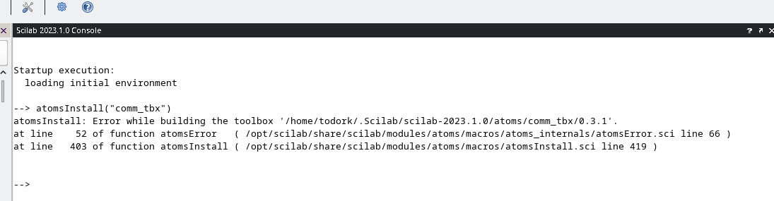

I met the following problem with Scilab 2023 when trying to install Communication Toolbox in:
Startup execution:
loading initial environment
--> atomsInstall("comm_tbx")
atomsInstall: Error while building the toolbox */home/todork/.Scilab/scilab-2023.1.0/atoms/comm_tbx/©.3.1".
at line 52 of function atomsError ( /opt/scilab/share/scilab/modules/atoms/macros/atoms_internals/atomsError.sci line 66 )
at line 403 of function atomsInstall ( /opt/scilab/share/scilab/modules/atoms/macros/atomsInstall.sci line 419 )
Probably this is upstream problem, but I will appreciate any suggestions and help
Regards,
Todor

Sorry,
I used screenshot to be more precize.
For the second part of your comment:
yes, I think that I’v followed the procedures of your links
