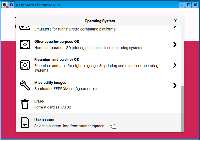

During the build process image, at the end, enter the root password in the pop up window that appears.
Don’t flash an image during the build image process, don’t flash your build image on your support during a build process.
To flash the image I use Raspberry Pi Imager.
1
Screenshot_20250203_093700_01
2
Screenshot_20250203_093833_02
3
Screenshot_20250203_093833_03
Follow the next step, Enjoy !
