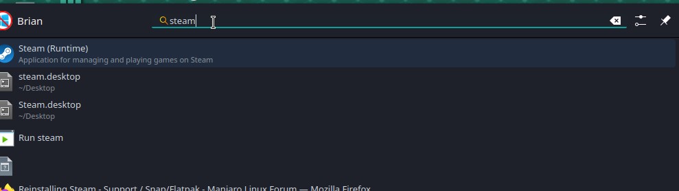

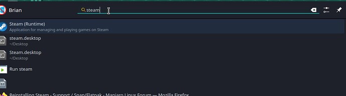

That’s there, but It didn’t go away when i uninstalled the Flatpac version.
flatpak uninstall flathub com.valvesoftware.Steam
then
flatpak uninstall --unused
Okay, ran those. Now run the Sudo install for Steam?
correct
I still have the icons in my Start Menu though, will that effect anything?
This should be done after a restart.
You can also use the “Edit menu entries” tool to reset the entire start menu and then set it up again.
Will do. Thank you for your help. Never had this issue before and don’t want to lose my steam access.
That worked! Thank you!
