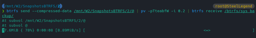

# mkdir /btrfs/sys_backup
# btrfs send /mnt/sys-back/@ | btrfs receive /btrfs/sys_backup/
I’m going to do this, made new directory /sys_backup…
Will delete and send the volume again.
