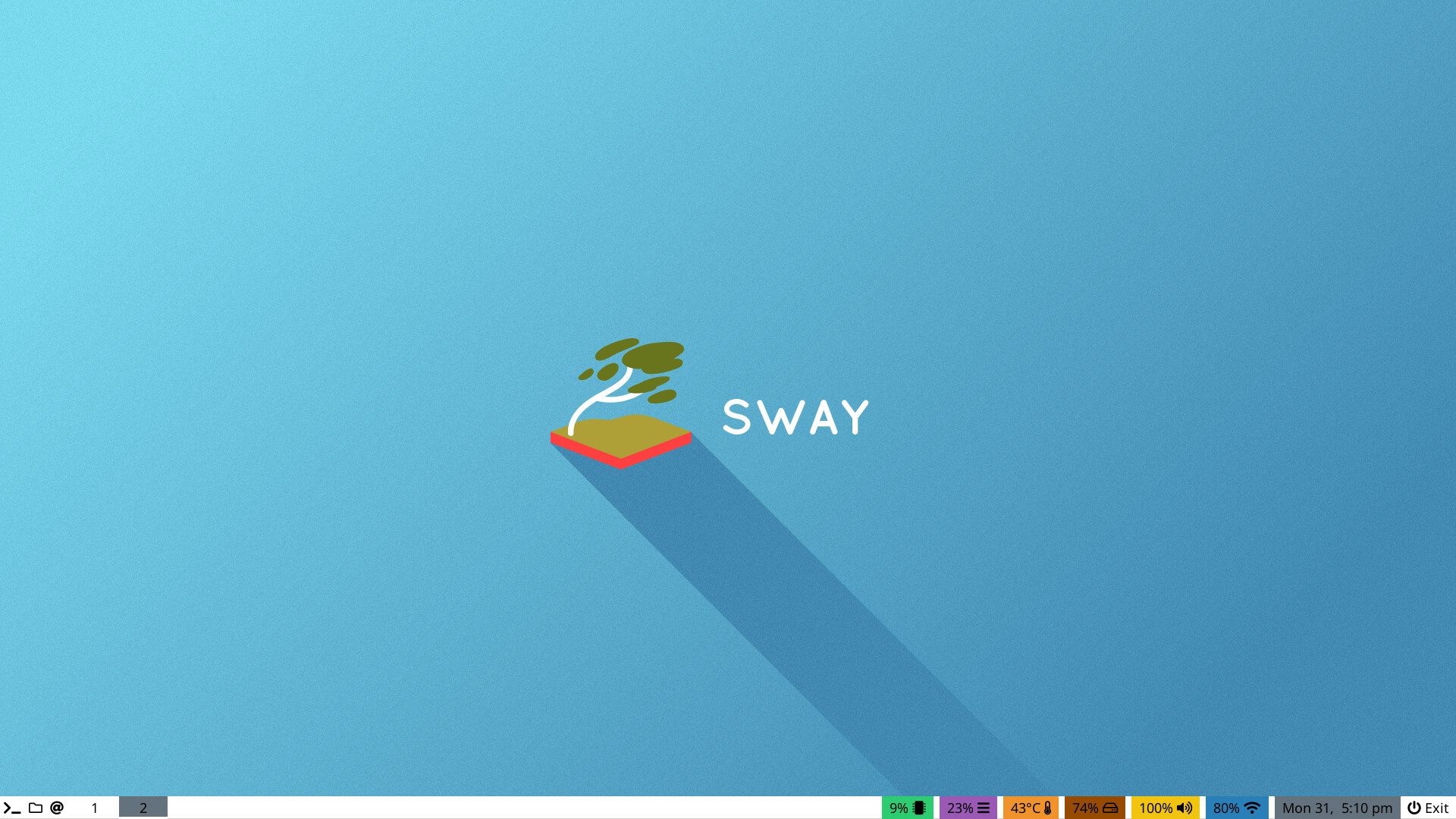

it’s to late for me, i’ve got it bad, just can’t stop messing with it.
today i messed with colors.
