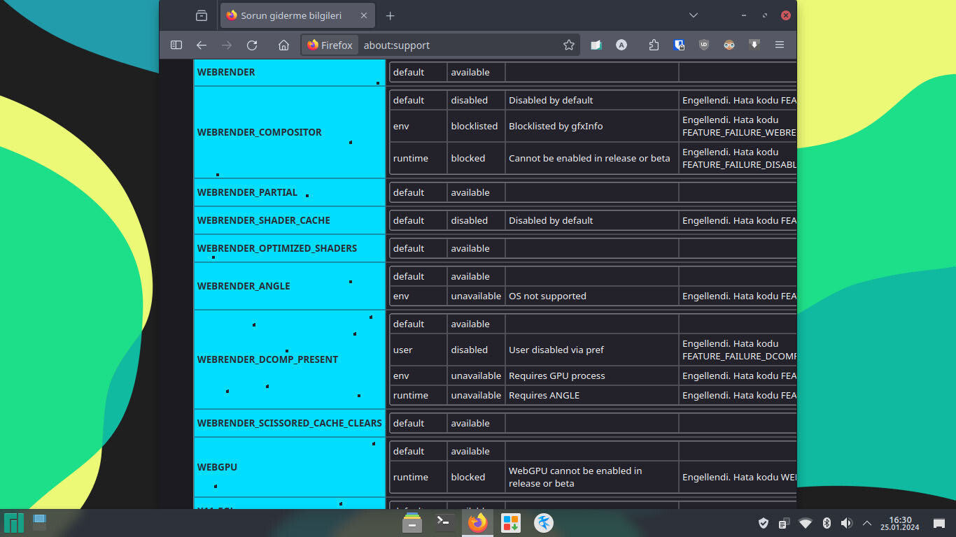

Random pixels appear on the screen in kde plasma and firefox
My computer has dual video cards.
  • Intel HD Graphics 4000
  • Nvidia Geforce GT 740m
  • Screen resolution : 1366x768
  • Intel is used by default
  • Xorg and Wayland have the same problem
    As you can see in the picture, random black dots appear on the screen in firefox. The same problem occurs in any window in Kde.
  • The theme I use is ArcDark but it does the same thing with the default theme
  • The same problem happens with other desktop environments but I don’t understand why (Xfce-Cinnamon-Gnome)

Since it shows up on a screenshot it can’t be the screen or a cable, as long as the screenshot is taken using software

okay, you’re at the internal intel-gpu. i would recommend to switch to nvidia.
a nice tool is envycontrol. install it with
pamac install envycontrol
run
sudo envycontrol --switch nvidia
reboot and post the output of
echo $XDG_SESSION_TYPE && glxinfo | grep server
after reboot

x11
server glx vendor string: NVIDIA Corporation
server glx version string: 1.4
server glx extensions:
After resetting and uninstalling optimus manager, I installed envycontrol and switched to nvidia. Unfortunately, just like with optimus-manager, the window maximization and minimization animations stutter and I have screen tearing problems. I think the only solution is to run kde with intel and firefox with prime-run with nvidia.
please use the performance-governor and test this before. i’m very convinced running this cpu@1200MHz is the reason for your lagging-problem in the end
cpupower frequency-set -g governor
I need to use this code, right? And what mode is this setting in by default? I’m asking to undo the setting if things go bad. I’m a little new to linux :slight_smile:
there’s nothing going bad.
you can always switch between the governors you’ll find with
cpupower frequency-info
usually they are performance, schedutil, powersafe etc…
keep in mind that these changes just temporarily and are set to default after reboot. check the link from archwiki and dig into setting up governor-scaling. you’ll find a lot in the net.
use
sudo cpupower frequency-set -g performance
