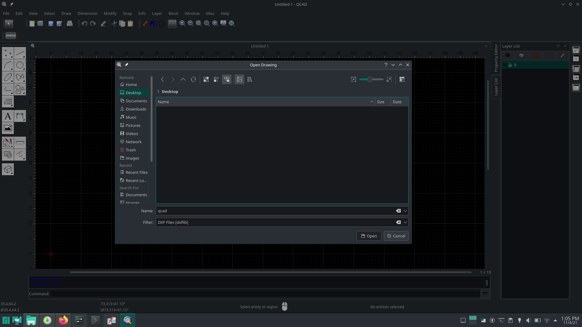

Qcad cannot open or save using the actual system file dialog
Once Installed Qcad by the official package manager I noticed all folders were missing when I tried to open a file.
I tried to save a simple draw, but some weird issue happened
Unable to create io-slave. Unknow protocol 'file'.
I ask some users to install Qcad and they did and had the same problem, one them said me the package came from the Arch and none Arch user report any issue about it, so its more likely to be a Manjaro issue

The last comes from qcad bugtracker: FS#1546 : 'Open file' dialog shows no files - although the directory displayed is full of .dxf files, which has a similar issue but is pretty old (2017) and also OS is different, things in common are Dolphin and KDE Plasma, probably both in old versions nowadays.
I would like to know what would be causing this issue and how to solve it. Any idea?

I still have this empty dialog. I tried reinstalling Qcad with no luck
I tried selecting everything inside, but it seems to be real empty, nothing were selected.
To prove it. I click on the box dialog and use Ctrl+A to select everything inside and then tried to erase them, but nothing happened

When I try to create a new folder the io slave error jumps, when I try to save a file with a new name it shows a warning saying it cant create it.

No, just inside Qcad file manager. But I starting to believe this is some kind of issue between modern versions of dolphin and qcad. I could probably get this working on an old version of dolphin .
This is how looks like when I tried this workaround
It looks pretty old, at least not what I’m used to see Dolphin nowadays.
But even managing getting work the save/open files I couldn’t figure out why the script reader is still unusable
As you see, I still get this white screen not showing directories neither files

Edit: I noticed the save/open file dialog is not the same as my system
When I open the save/open file dialog it shows a warning saying
couldn't create slave: "Unknown protocol 'file'."
A previous warning saying (Warning: Could not find any platform plugin) happens when clicking any button in the toolbar
