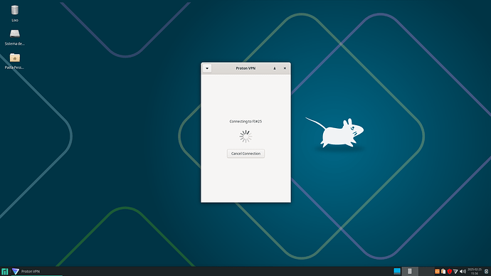

I’m subscribed to proton vpn. I installed it but although the servers appear, it connects and disconnects automatically and then gives an error.
18:08- In settings I’ve solved a tiny part of the problem: the connection is stable, but I can only see images on the Portugal server, on the others I get a black screen and errors.
