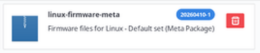

Programs from the AUR that I haven't installed
Why are these packages installed on my system if I’ve never installed anything from the AUR?
Both of those packages have recently been removed from the repos. You can safely remove accounts-qml-module as nothing in the repos depends on it.
However, if removing linux-firmware-meta, then you can replace it with the linux-firmware package which has the same dependencies.
You can remove linux-firmware-meta completely & not install linux-firmware, however if you plan to do that, then you should read the following post to ensure that you don’t remove any required firmware packages from your system:

Packages that got dropped from the repos as not needed anymore (like the qml) or got replaced with something else (like the meta) end up as aur that you didn’t install or as foreign packages not even from aur (from nowhere like the meta). Usually they can be removed.
Screenshot in original post does not show linux-firmware-meta as an AUR package
but it is a Foreign package since it was dropped from Manjaro repository
