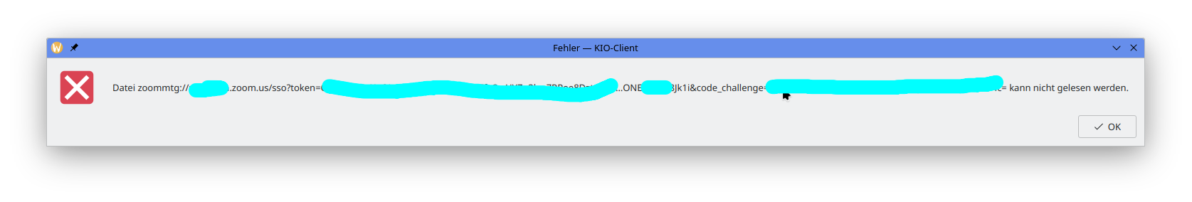

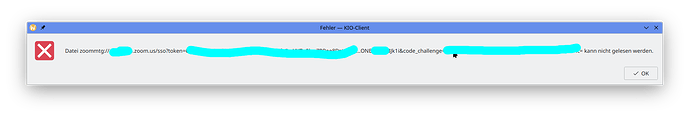

When I change my default browser to Chromium, I am getting the following error:
I think something is wrong with the URL scheme handler, but I don’t know how to solve it and don’t find any helpful hints on the internet.
I checked the default scheme handler and it points to a valid Desktop file:

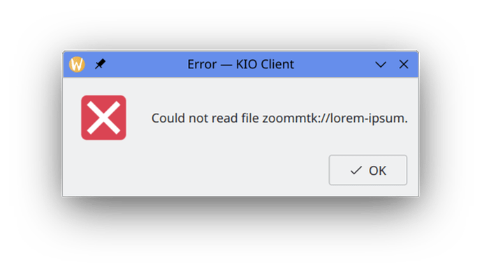

Does it work in the terminal?
xdg-open zoommtk://lorem-ipsum
xdg-open zoommtg://blabla
I am well aware that the AUR is not supported by Manjaro officially, nor is Zoom to run on Manjaro (probably).
That’s why I am hoping to find a solution in this forum and explicitly flagged my post with the “AUR” category.
I always find the AUR comment section a bit hard to use.

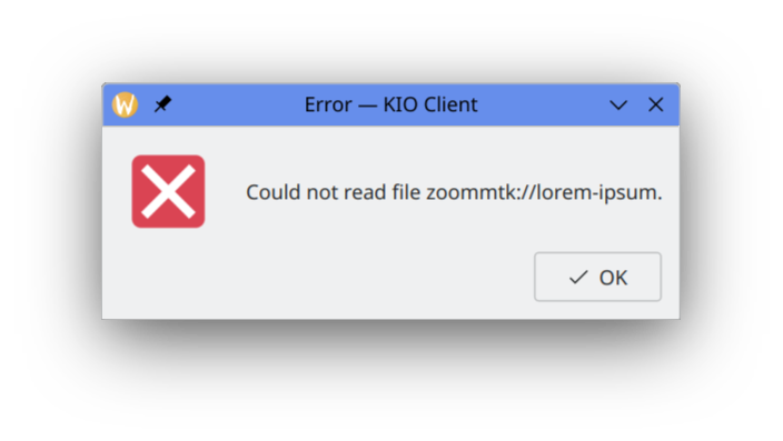

This shows up:
I get the same error when executing xdg-open zoommtg://lorem-ipsum
I’m sorry, it’s supposed to say
