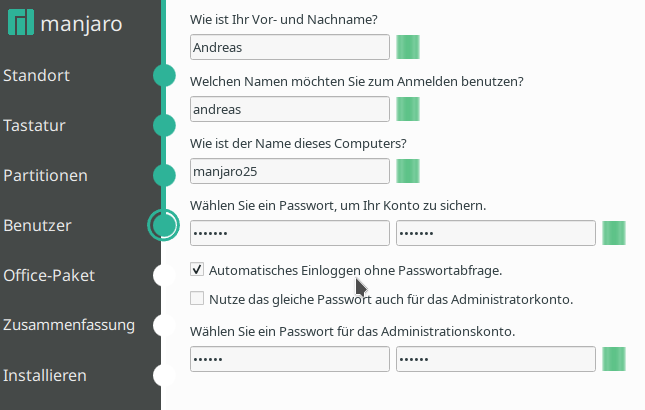

I’m currently reinstalling my system. I’ve gotten stuck at a few points because Calamares hasn’t been behaving consistently.
  1. During the first installation attempt, I selected passwordless login because that would be quite practical for a disaster recovery system, as it would allow me to jump straight to the GUI.
  • After the installation, I did indeed jump straight to the GUI.
  • Then I tried to install a few programs I like to have on hand using Pacman. However,
  • I couldn’t gain root privileges with sudo. My password was rejected.
  • Then I tried su root, but the root password was also rejected.
    No, no typo, no mixed-up password, no Caps Lock. The terminal itself displayed all the letters correctly. And no, the password doesn’t contain any characters that are located in different places on an English keyboard. I was able to type the password as text in the terminal.
  • While I was still wondering what the problem could be, the screensaver appeared. It also didn’t accept my password.
A fresh installation without passwordless login now doesn’t have the problem.

I think you’re not quite up to date.
I did enter 2 passwords (user, root) and they are not the same.
The GUI started without password, But none of these passwords worked in the installed system
(this is no passwordless installation, but only a passwordless login)
It’s the latest ISO for XFCE.
Yes i could, But
No, unfortunately I can’t do that anymore,
as I reinstalled immediately afterward without checking the relevant box. (I’m currently reinstalling my system, not troubleshooting Calamares in general.)

Oh - that one…
I never pay any attention to that field - never use passwordless login - and I completely misunderstood the passwordless login - I understood as, in not supplying any text at all - my mistake - sorry.
Nonetheless - my test was done leaving all password fields empty and no ticked boxes - creating yet another mystery :grin:
I will check the other scenario you describe - just to satisfy my curiosity.
