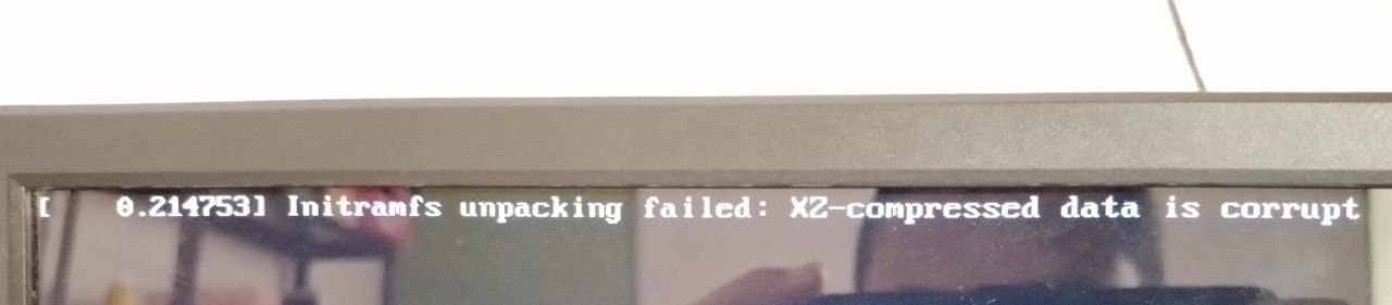

This screenshot below is when I try to access it with balena etcher ![]()

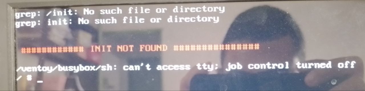

This is when I made the bootable pendrive with ventoy ![]()

Hello @jjacsan and welcome ![]()
No matter how you look at it: Data is corrupted, that’s why it won’t boot.
The pendrive is working normally, I will check the integrity of the iso
Sorry for the delay, everything is fine with the iso and my pendrive. Apparently it’s a grub 2.12rc1 problem on Linux distros with grub 2.06 or systemd-boot is working normally
