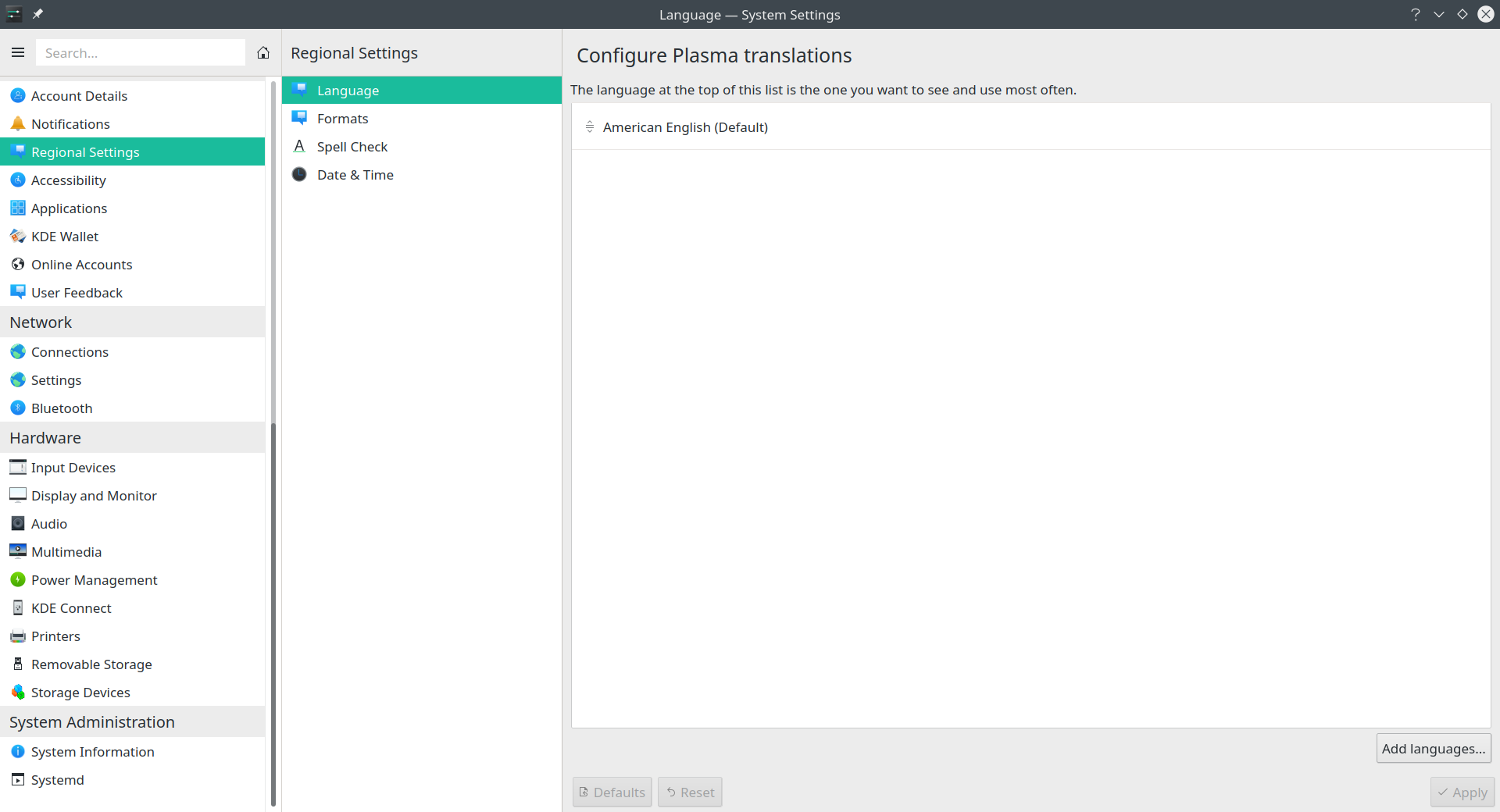

Regional settings:

Can you do me a favour and add an additional language in KDE’s language section? ( or will do)
(not promising anything, just trying to have KDE regenerate its own settings as manjaro-settings just takes its info from the DE).
drbb
4 October 2020 17:15
9
Done that. As you can see it even switches language correctly, however locale settings are empty as before.
