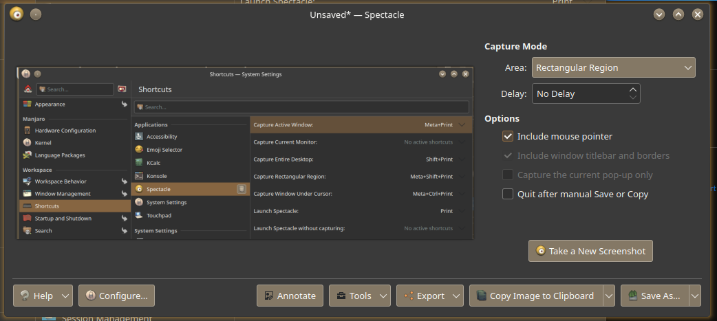

perhaps you need to open spectacle and then configure the printscreen function - when I am creating manuals I am using the delay function to be sure I get the right shot

Since you already use it, I’d recommend sticking to it. I use it, also with Plasma, and it’s working like a charm.
Check that the shortcut for it is configured in System SettingsShortcutsShortcutsShortcutsFlameshot as mine is below.

Furthermore, in the Flameshot configuration itself, ensure that have the option checked in the General Tab to launch it at startup:

Hope this helps!
Thanks both of you!
@linux-aarhus : I’m using Flameshot, therefore I marked that as a solution but yours is just as well a solution for all who use spectacle.
@Mirdarthos : your hint to the Plasma Preferences made my day. I was looking for a shortcut in the Flameshot preferences.
