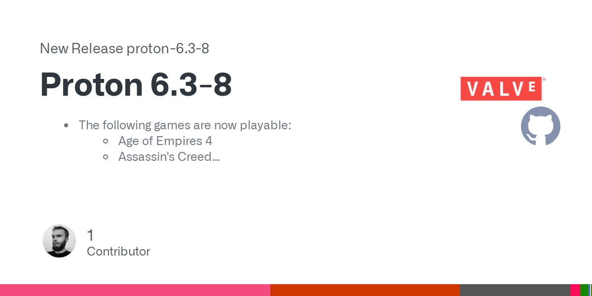

You need to force nvapi variable in your Proton startup command with the proper Proton version, and in the config file (I assume this is exactly what you are talking about, right? You Windows games under Proton in Steam?)
Support DLSS in DX11 and DX12 games (guarded by PROTON_ENABLE_NVAPI=1 and dxgi.nvapiHack = False).
Also you need to have the Nvidia video card being the one used to run the game obviously.
You can simply try to modify the Launch Options of the game in Steam by adding PROTON_HIDE_NVIDIA_GPU=0 PROTON_ENABLE_NVAPI=1 %command%
