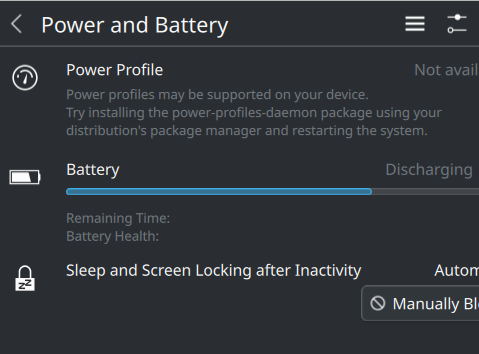

After uninstall TLP, cant change power profile (before installing TLP it worked)

FIXED:
Fixed by instaling power-profiles-daemon with sudo pacman -S power-profiles-daemon
